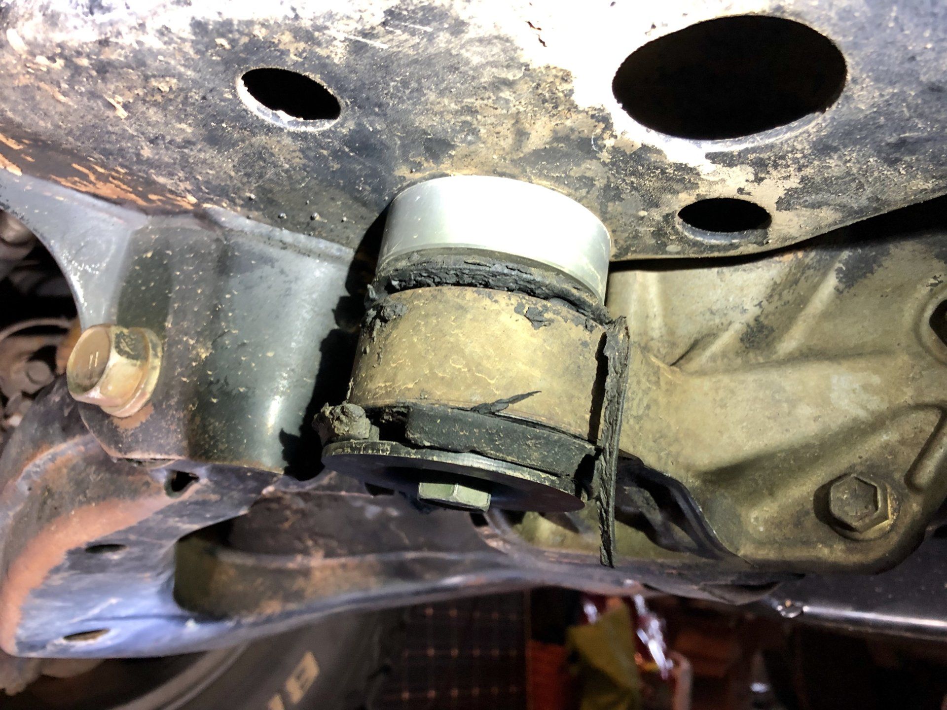

Your vid was one of the most informative I’ve seen. Made me go check out my new clunking noise. Rear bracket with bushing was replaced about a month ago. Now a new clunk when going into drive. Yep, front bushings shot. Ordered them from Conicelli Toyota (discount Toyota dealer). Thanks for posting!
Your vid was one of the most informative I’ve seen. Made me go check out my new clunking noise. Rear bracket with bushing was replaced about a month ago. Now a new clunk when going into drive. Yep, front bushings shot. Ordered them Conicelli Toyota. Thanks for posting!
Now THAT is one shredded bushing. That should feel much better once that is replaced! Glad the video helped you out.
