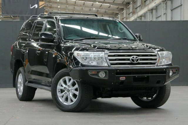

I suppose ARB wants their bars to look big, I.e. beefier and affording more protection. I did manage to find a photo where the bumper (minus the rails) looks more acceptable to me from a minimalist standpoint (below). I may go with that.
Pet peeve: one would think that for $2k, a company would have more a handful of stock photos of the item in question. I know some vendors have hundreds of customer photos. That would be nice to see from ARB.
This one as well.
