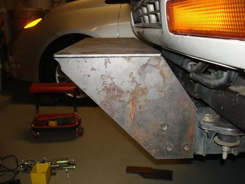

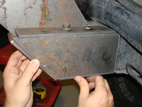

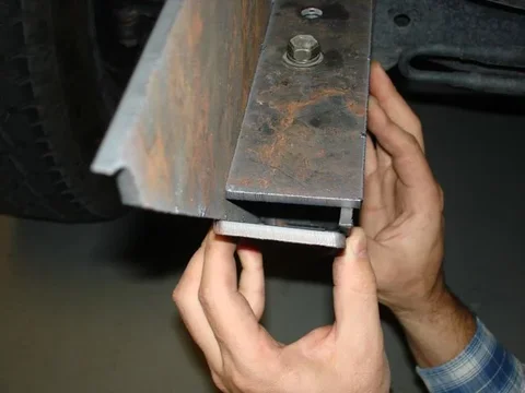

I've had the winch in my garage for a year and with the weather cooling down I've gotten off my ass and started putting this together. I'll keep posting as it comes together.
I've uploaded my limit of three files...guess you'll have to wait until my web server is up again...
The bash plate on the front is .25" thick and rests there at 45 degrees. The rest of the material is 3/16".

The main supports will be in flat...the rest will be tube...
