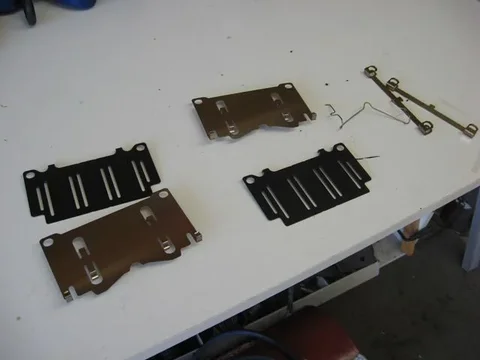

Just some info on possible brake noise. Be sure that you put all the hardware back in. I've had this little rattle that was driving me nuts and I found that the previous owners shop cheaped out and left some shims out. This is all I found in the caliper when I pulled them out.
The factory shims require that you remove the caliper to install the pads in them so tabs can be inserted into the pistons. This keeps the pads from shifting and creating a clicking noise. They are a puzzle, but after you install everything, they are nice and quiet.

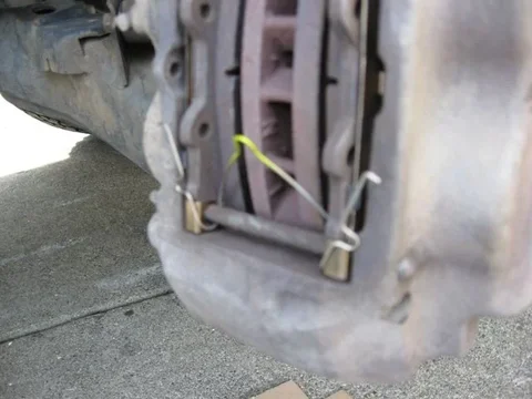

Also, 2000 and up have a "W" clip that set tension on the pads. These are shown "loose" and have to have the ends tucked into the holes at the top of the pads.
