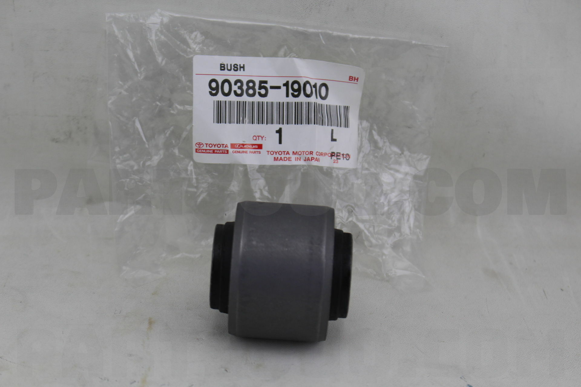

did you do the rear as well? I saw you bought four of the same lower bushing, but I have a different part number / diagram noting a different rear lower bushing.
