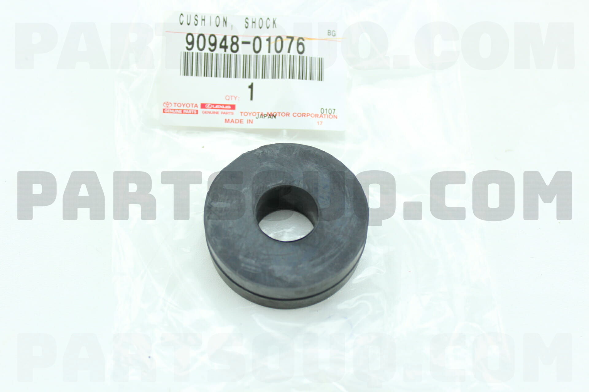

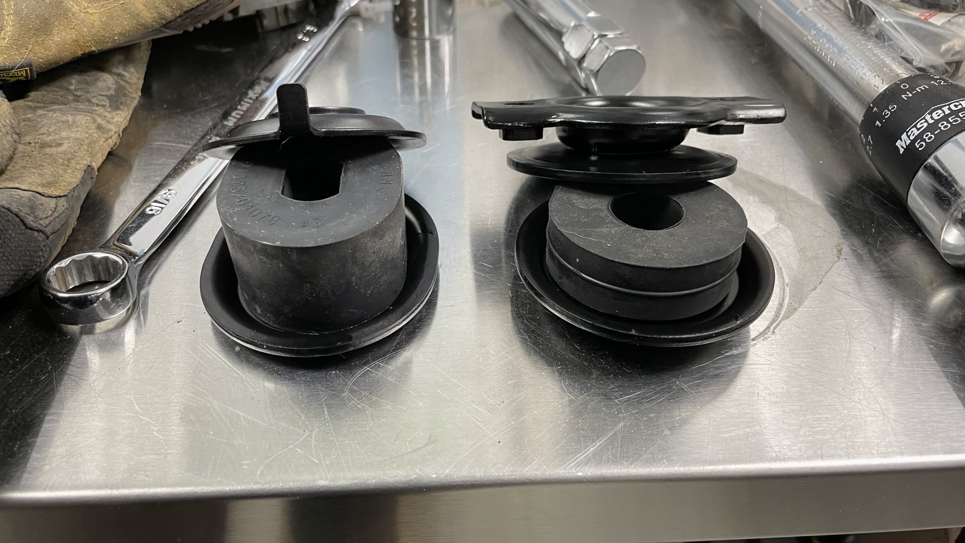

well dang, turns out the bushing you used are for a normal shock, non AHC. Which, it being a rubber donut, you can make it fit. But, going back into the parts fiche, and translating some kanji symbols, it's 2x different bushings. Top is wider and flatter, bottom has a squared out hole for the shock shaft. Not sure how important it would be, but for the $80 to order from Partsouq, vs the $160 the dealer wants + weeks longer shipping, I just ordered the right ones.... oh well, maybe next weekend then.
these are the actual bushings from the VX with AHC (JDM)

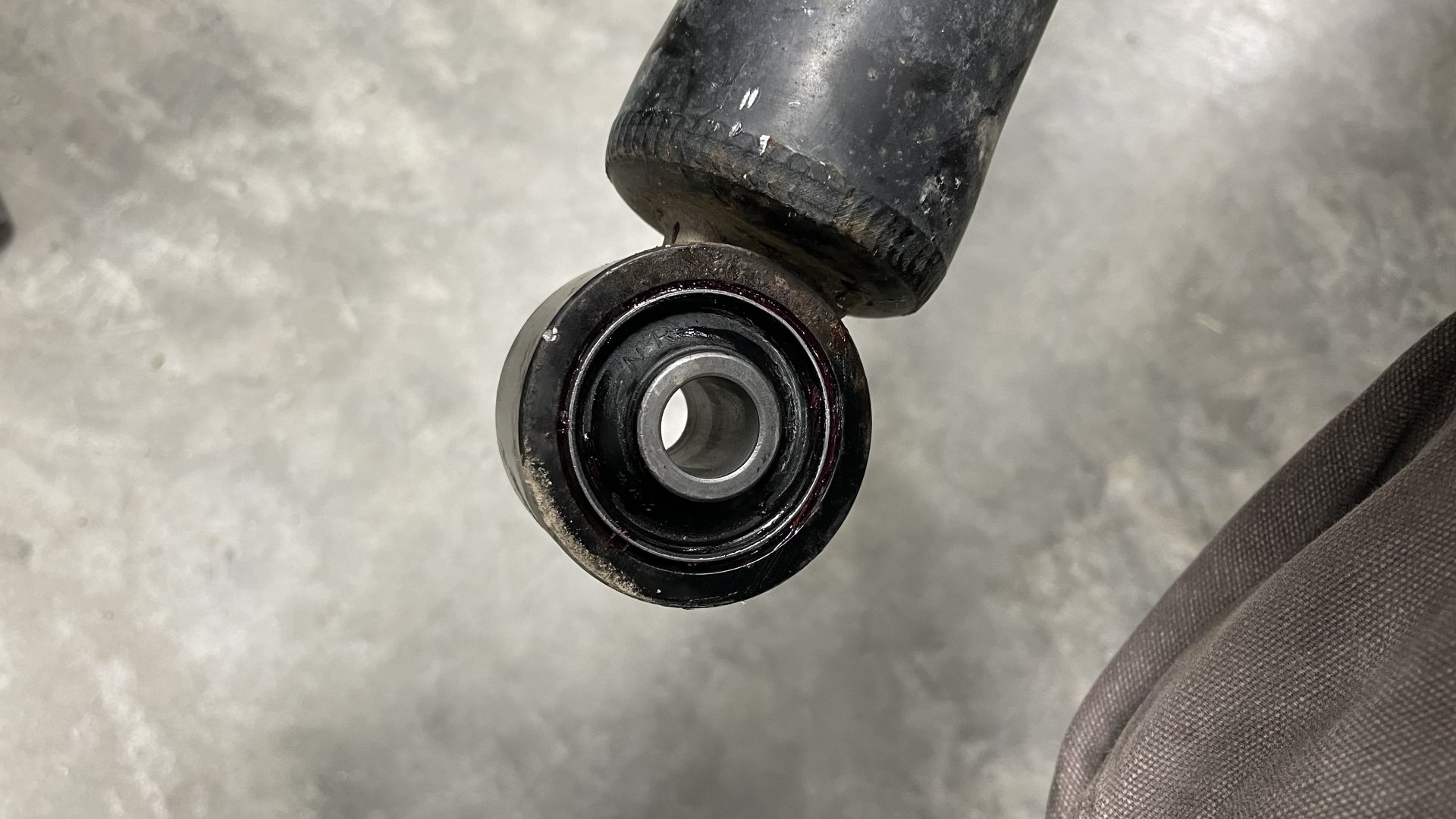

Process has been pretty smooth. All the bushes were toast. Looking forward to some new found plushness. Made a lower bushing press in tool, which worked much better than trying to balance a socket on a knife edge!

The parts listed the OP showed, are not correct, they are for traditional shocks, smaller and narrower.
Double check your own VIN for correct parts, and the non-reusable pieces such as the o-ring + back up ring + top not were not replaced by OP either.
