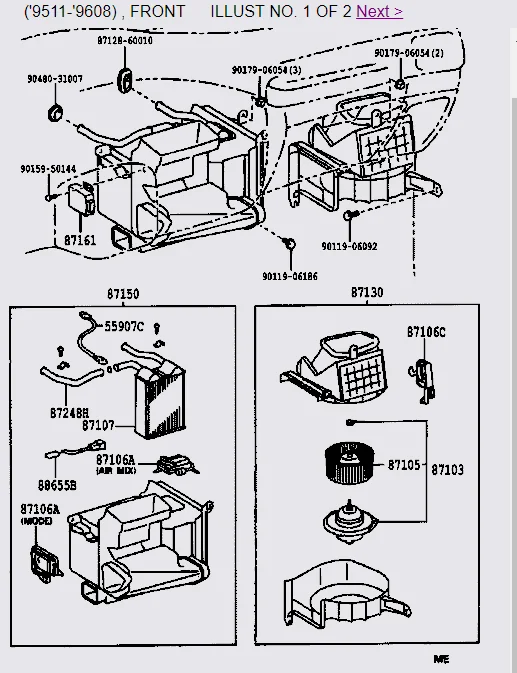

Also recirc air button doesnt illuminate when pushed, stays stuck on fresh ousdie air only so thinking maybe the servo is not working correctly for recirc and likely the servo for air mix. Part numbers/diagrams for those servos are here incase anyone needs:
87106-60060 AIR MIX servo
87106-60020 Blower servo
