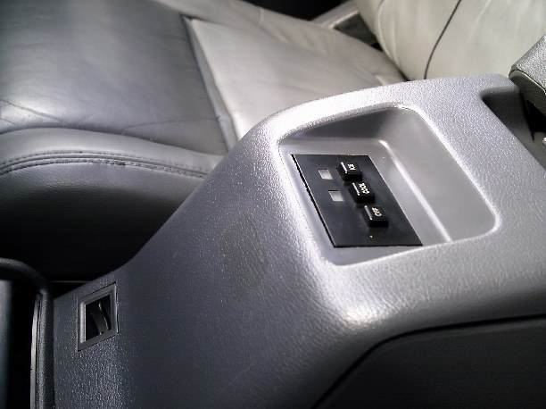

Can you post some pics of your cool box?
Sent from my iPhone using IH8MUD
mine ..
that is cool! does it freeze and cool?
