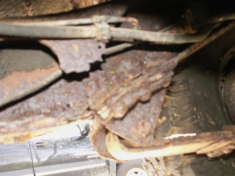

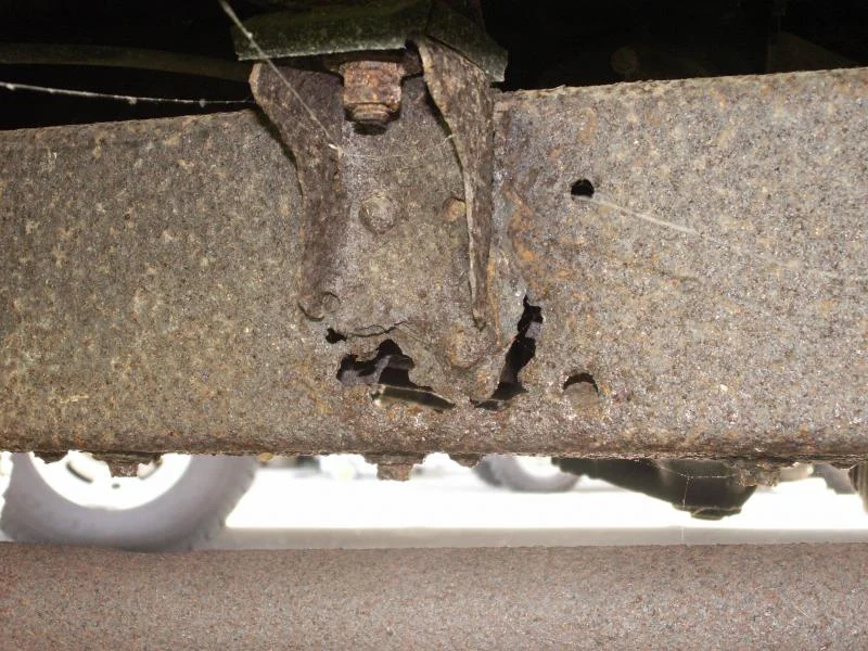

ok.. so here is what i am talking about... I know these pictures don't show it all, but it shows what i'm dealing with..
Ya I hate to say it but I think if I were in your shoes ide be lookin for another frame right about now.
x2
Plating can go so far, but in the end, a new frame is a better choice.
They are available for fair money occasionally.
I would be PMing Kina, he might have one. Post up in the wanted section.
Like wildman said, the rest of the frame is most likely compromised.
