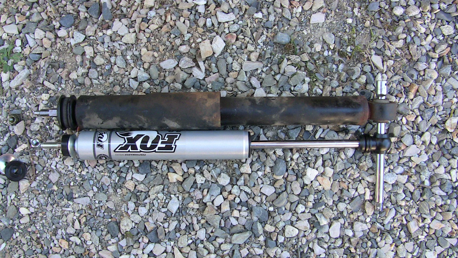

Wazzup people. I picked up the Fox 2.0's a few months ago to replace a busted AHC system. I'm using them with OME t-bars and 865 springs. Here's what I think:
-They're a good option for someone who isn't going to put weight on the truck. A nice "Lexus-y" comfort shock. I can't honestly compare their ride to AHC as mine was broken with an extremely harsh ride from shortly after I bought the truck a few years ago. With the Slee front/mid/belly skids and Metal-Tech sliders I'm in good shape using the truck like a bus (8 people) or filling it with people and stuff. If I had heavy bumpers in addition that would put me over the edge and I would spend the money something with more dampening.
-As has been mentioned before, the rebound on the rear shocks is under-damped. It's not a big negative for me but I notice the butt pops off deflections a little too eagerly.
-I haven't been off-road with them yet. This truck needs to pass import here in France before that as I can't technically insure it as of now. My understanding is that they are modest in the flex department, but not as bad as Bilstein. They're not for you if you're looking for a lot of extension. Here are a couple pix I took comparing them at full extention vs the AHC tubes. Going by where the hat would hit the mount, it looks like I lost around a half-an-inch of extention on the front (pictured). Not a lot, but annoying. Doing the same for the rear I lost not more than a quarter-inch.

Bottom Line: I recommend the Fox 2.0 shocks for someone with stock to mild weight and lift who wants a comfort oriented ride at a fair price.
