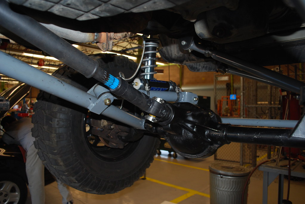

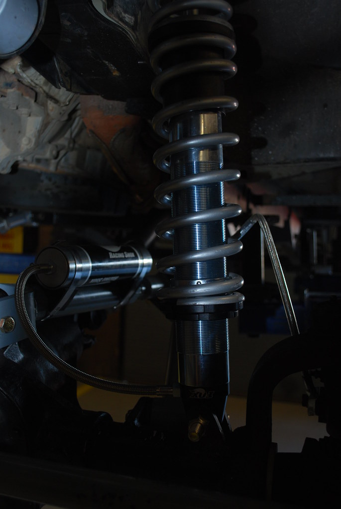

If you are having reservoir clearance issues you don't have to strap them to the shock. Here is how I did mine on a previous rig. I called Fox and they said this orientation was acceptable and that they could be mounted upside down or right side up. Note, that some of their shocks that have already attached reservoirs can't be flip flopped. You don't want them getting bound up and possibly broken open with 200psi. Not to mention they cost a pretty penny [URL="http://farm5.staticflickr.com/4068/4283130057_f23c46a2ce_b.jpg"][URL="http://farm5.staticflickr.com/4068/4283130057_f23c46a2ce_b.jpg"][/URL][/URL][URL="http://farm5.staticflickr.com/4038/4283885400_e89e7bc3ed_b.jpg"][URL="http://farm5.staticflickr.com/4038/4283885400_e89e7bc3ed_b.jpg"][/URL][/URL]
