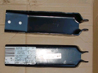

I bought the lower mount protection from someone here on mud
When I remember who it is I will post it up
Lower mount protection

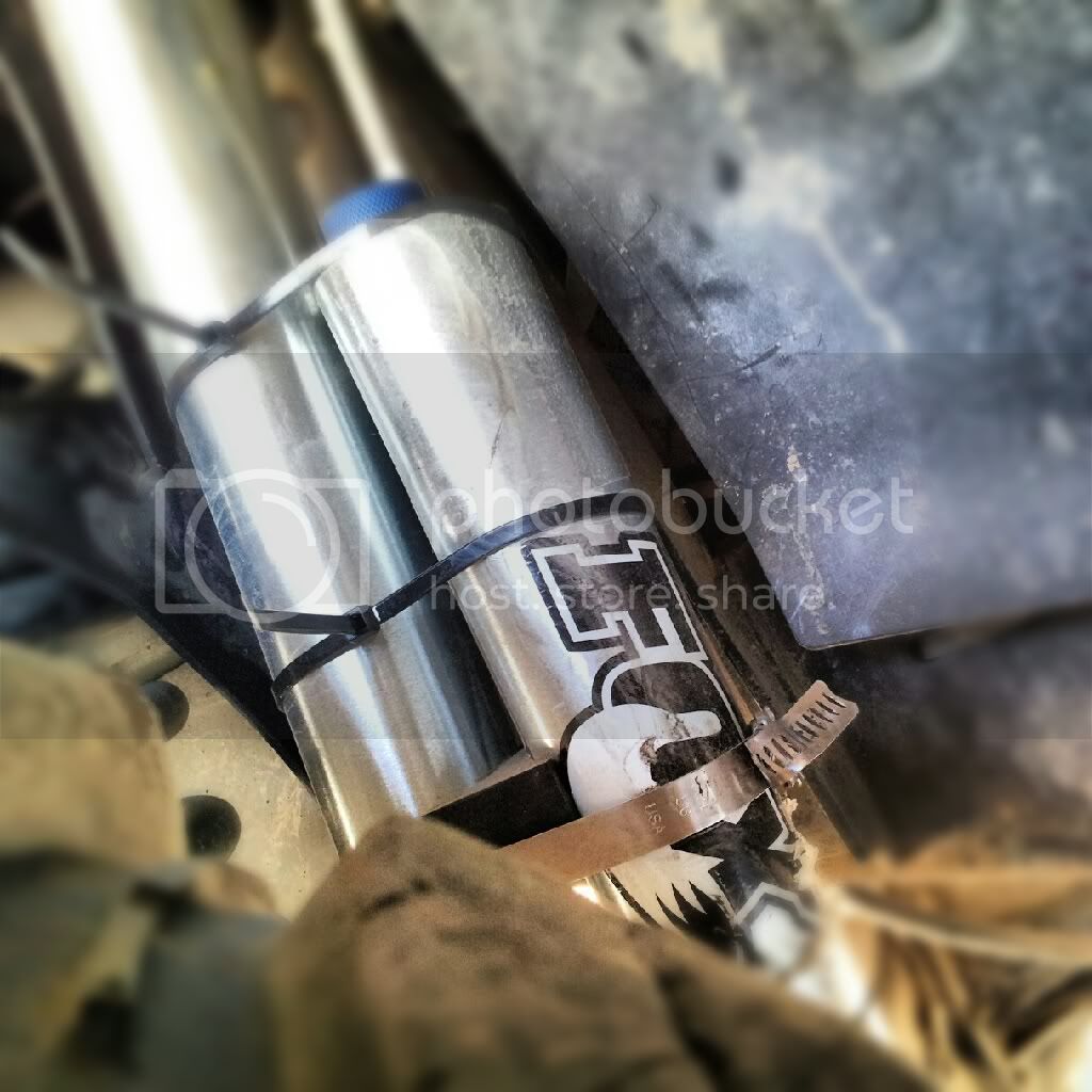

Were you able to test your set up? I went the Fox route as well. Took my rig out yesterday to Cleghorn trail for shakedown run. Those in SoCal will be familiar with "Cleghammer" and the various obstacles on the trail. The set up was put to the test. Everything worked well but my resi mounting locations...
Used some zip ties while on the trail to hold driver side resi. Lost on strap and rubber spacer due bad tire rubbing.

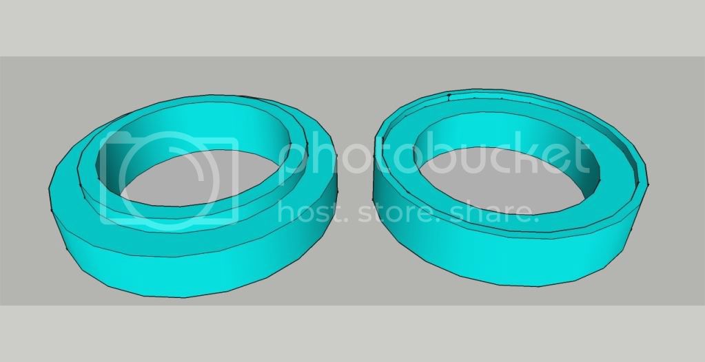

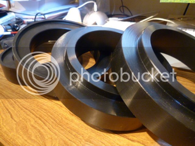

Well, life happens and I'm only getting to sorting my bumpstops now...:rolleyes: I'm also going to fit some 30mm coil spacers I had a mate make up.
From Drawing...
...to made!

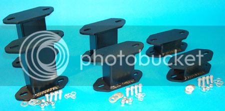

Now the plan is to get them done this coming weekend. I'm going to fab up something up akin to the Man a Fre Bump stop drop brackets.
