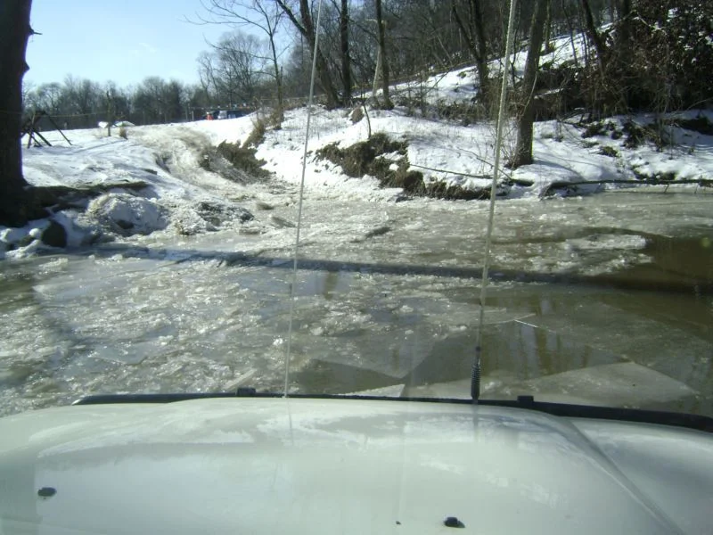

This is the deepest I've gone with my snorkel, just above the tires crossing the creek at the cliffs. I have to admit though it can make you stupid sometimes. I wanted to cross the creek one time after heavy rain even though Tom decided to go around.
https://forum.ih8mud.com/attachment.php?attachmentid=209121&stc=1&d=1202772672
The snorkel doesn't disconnect your fan. It will hit the water, possibly bend, and certainly throw water all over your plug wires and cap. The snorkel doesn't do anything to keep the water out of your diffs, transfer case or trans vents either.
