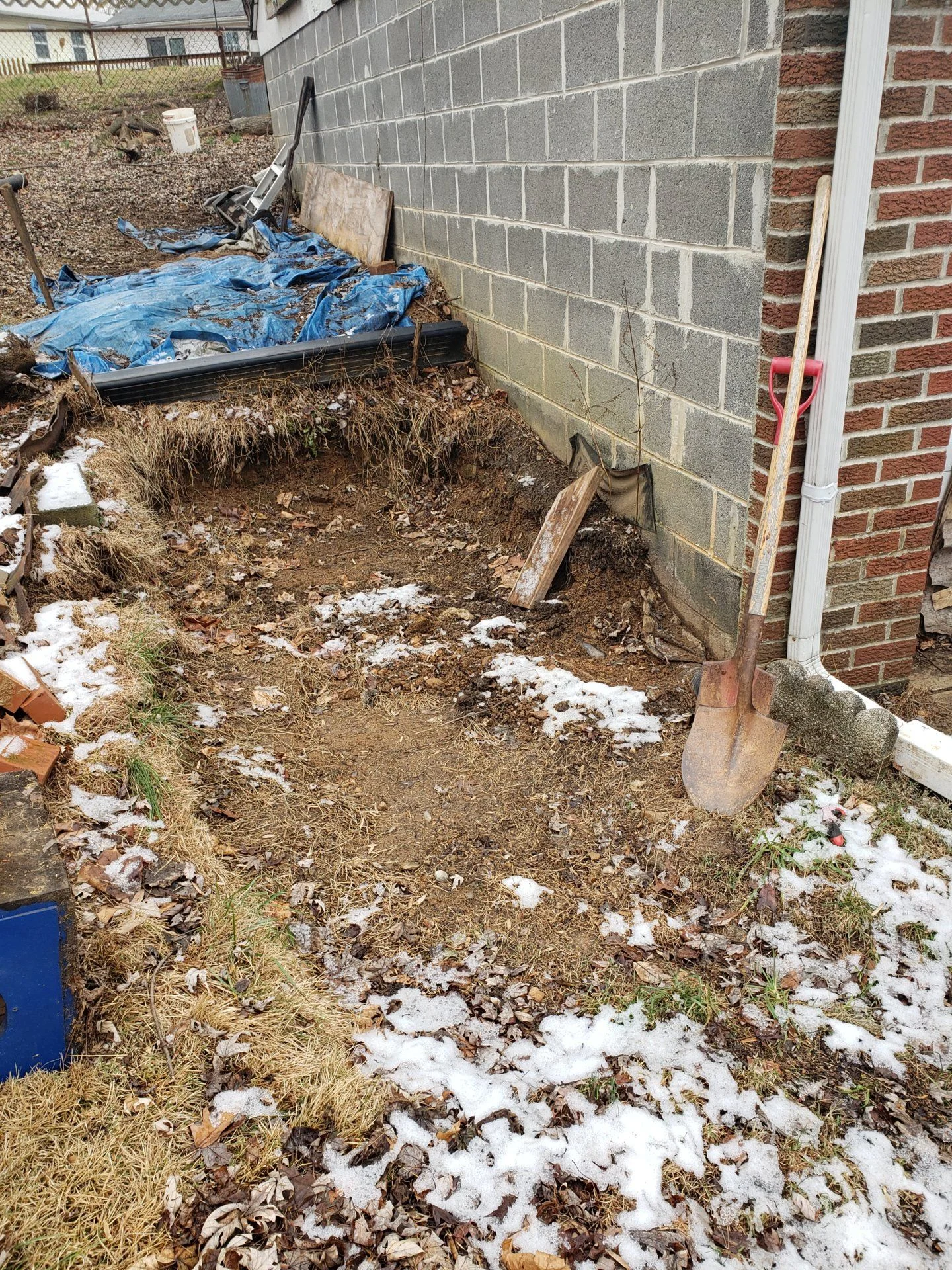

@Betteron2wheels I didn't see your picture when I posted earlier. Will the door to your new space be on the downhill side (where the shovels are) or somewhere else. Also, will it have its own door or will you cut a door opening into the cmu(concrete masonry unit/cinder block) wall in the photo?
sorry:bang: my reading comprehension isn't what it used to be apparently. It seems like your biggest area of potential problems is that uphill side; I say drive on with what you were thinking (footing and cinderblocks) to retain the earth on that end.

@Betteron2wheels I didn't see your picture when I posted earlier. Will the door to your new space...
The door will be where the shovels are. I might put a small window on the existing wall between the 2 spaces if time and patience permit.
