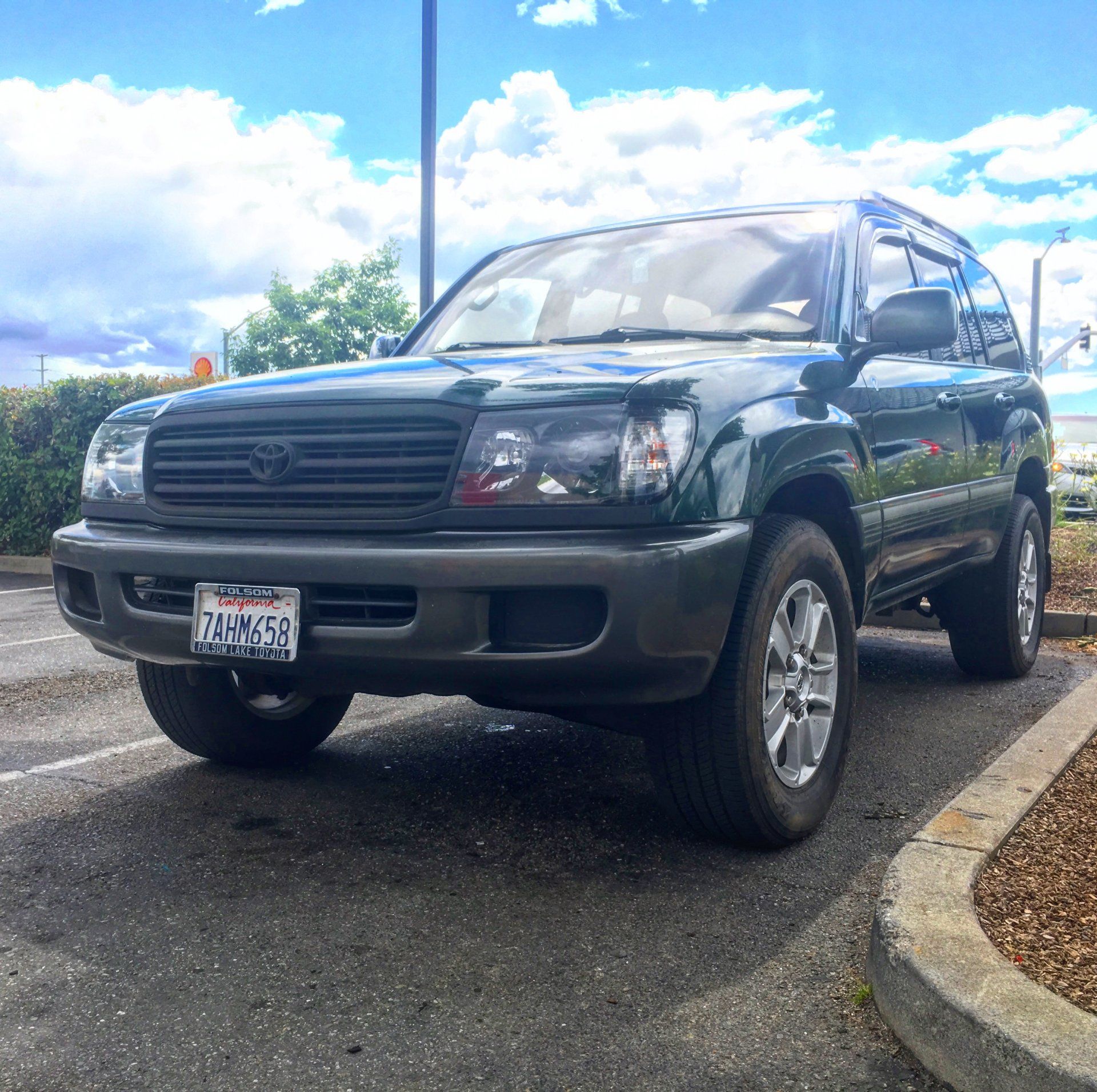

I traced the shape of my fog light (lens down), including the mounting tab toward the outise of the bumper. This way they mount exactly like the fog lights would. I simply used a little bolt and nut (head painted black) to keep it all in there snug as if it were OEM. With projectors, my fogs were completely useless, so I'm not missing them at all.
It's been raining all day, whats left of Harvey that has made it up here to New England, and no water in the lenses after 30min round trip to Concord on the highway. So, The oem rubber gasket and rtv sealed them up just fine. Now to see how well the rest of it holds up.
