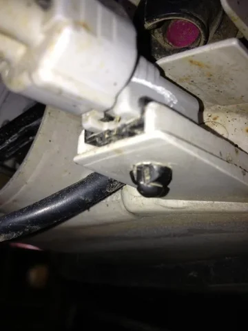

Removing the lights form the bumper is pretty straight forward. Three nut on the back. They should then just pop out when you push on the back of the unit. Thy can be quite sticky when they have been in your bumper for a long time as dirt builds up.
Once they are out, there are two plugs that you basically unplug. There are little lips that keep the plugs in place. There is also a little tab that holds the wiring in place. You can use a plier to work it loose form the unit.
Here a picture of the back. You can see one nut and those plugs

Awesome, I'm trying to figure out if your lights will fit my truck. I have a '98, as far as I can tell, they didn't change them, but I'm not sure. Anyone have an idea? How much would you'd be asking for the pair? Is this black knob the plug you are saying you pull out with pliers?IMG_0284.webp

And yes, that is the little knobby thing. Just push the two wider pieces in (blue arrows) with a plier and push up (red arrow)
You can do this while the unit is removed from the bumper. The wire should be long enough.
