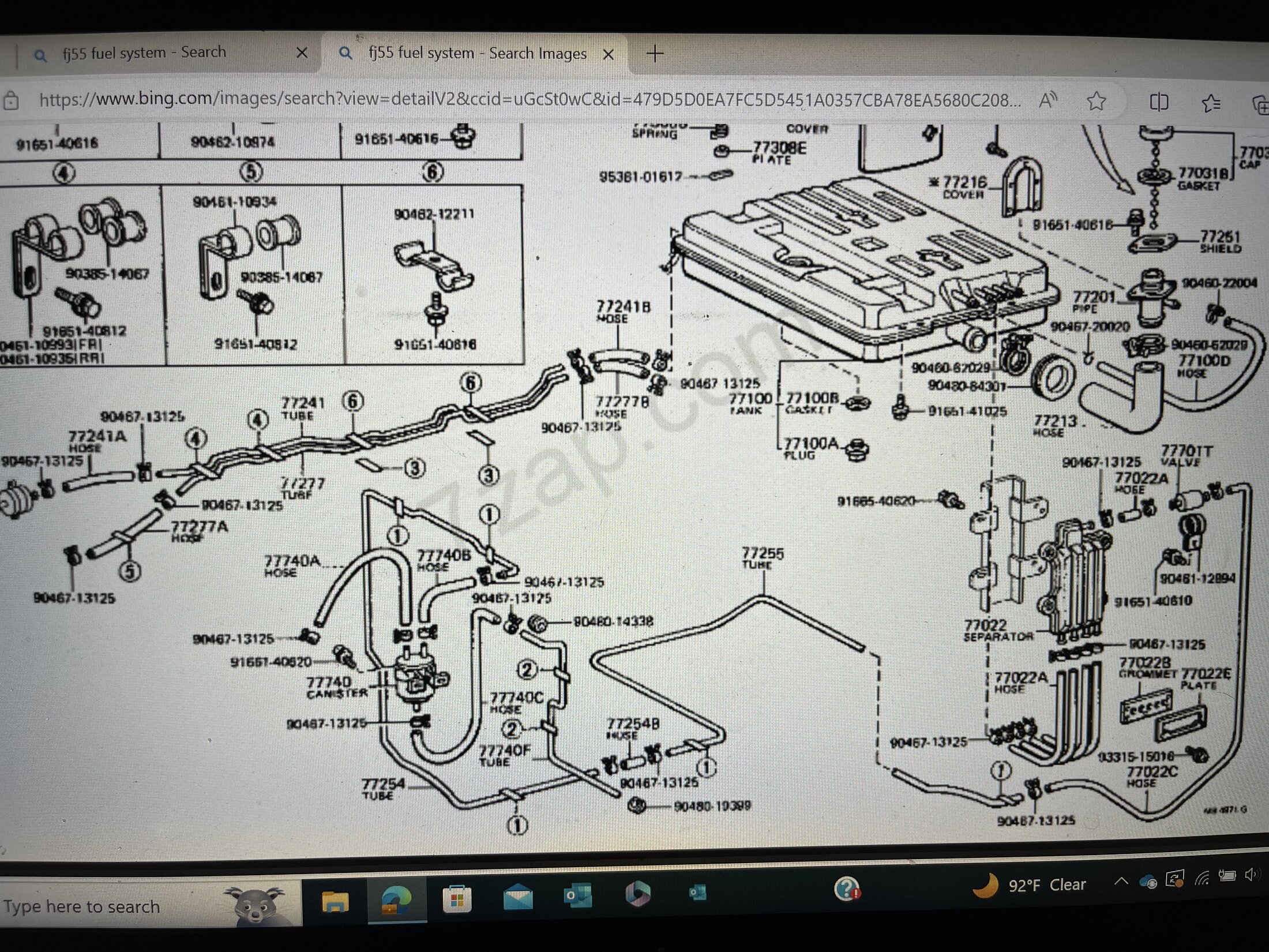

Does this valve look like it has proper orientation?
I’ve pulled lines off the charcoal canister and blew into each line. No obvious blockage as I was able to blow into it with a little difficulty which I attribute to the caliber of the line. Same for line coming out of the valve by vapor thing in rear

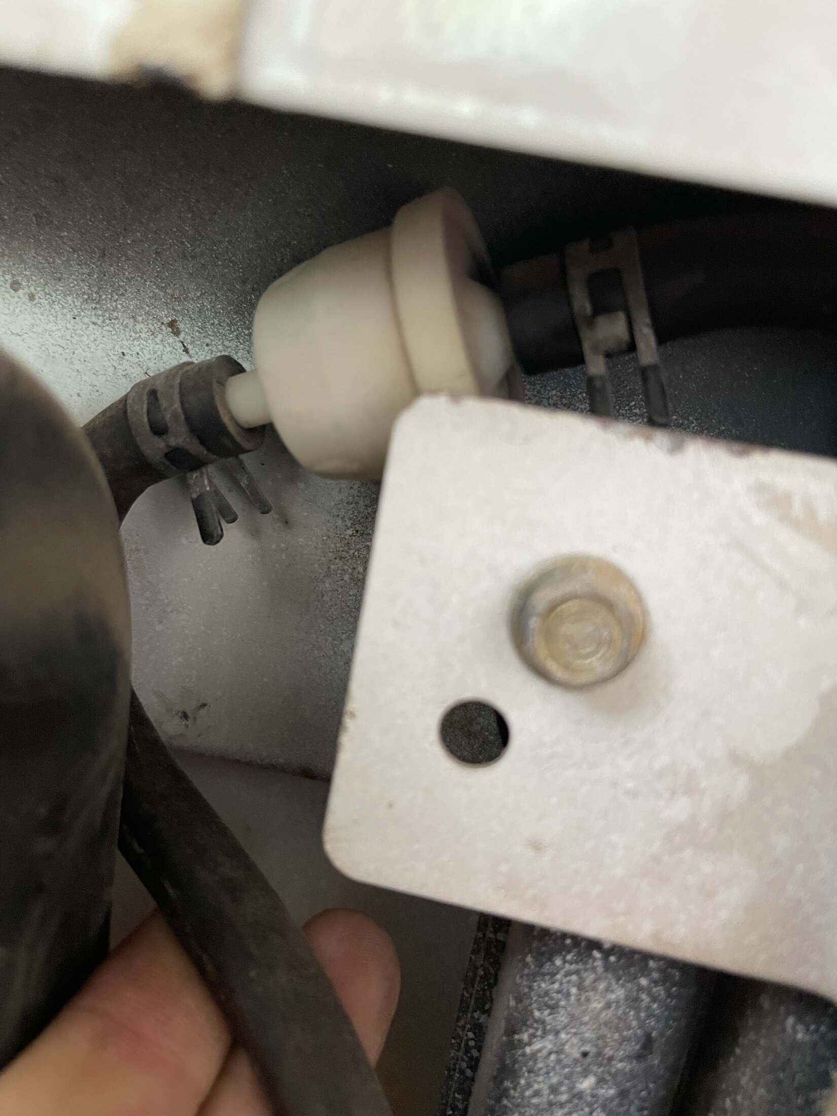

As long as that valve will let air flow pass from vapor separator > to > charcoal cannister, you are good!

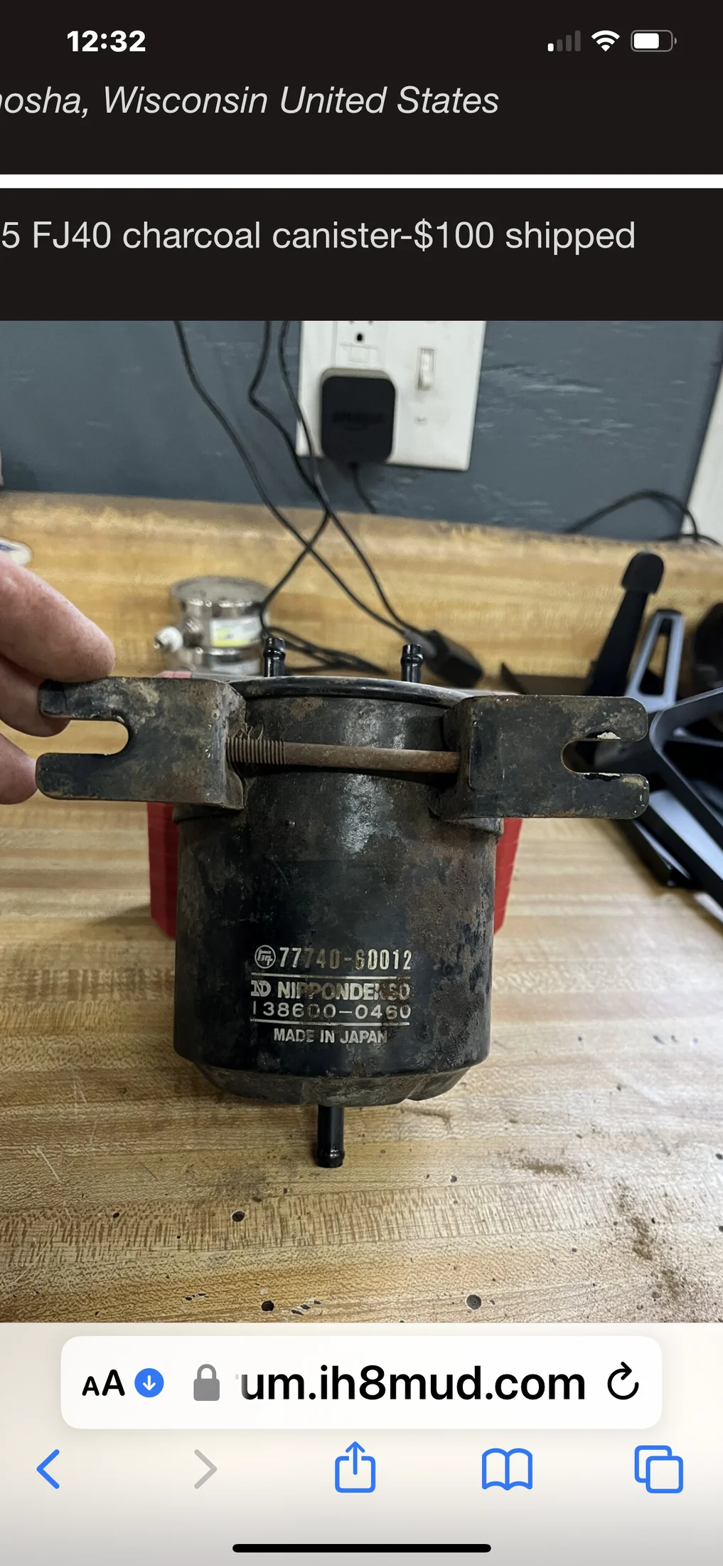

Contemplated replacing that, one for sale on mud.
Wonder if this would be decent swap?

Valve checked, air flowed in direction it should. I’m still digging here
