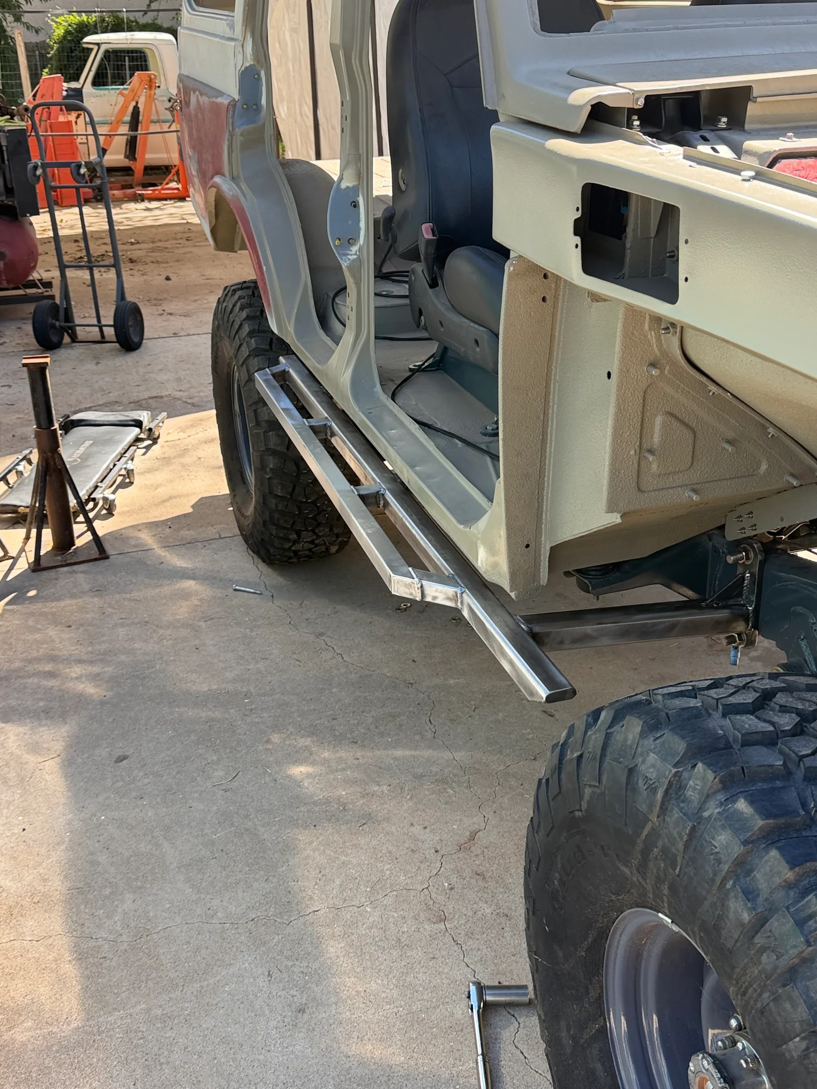

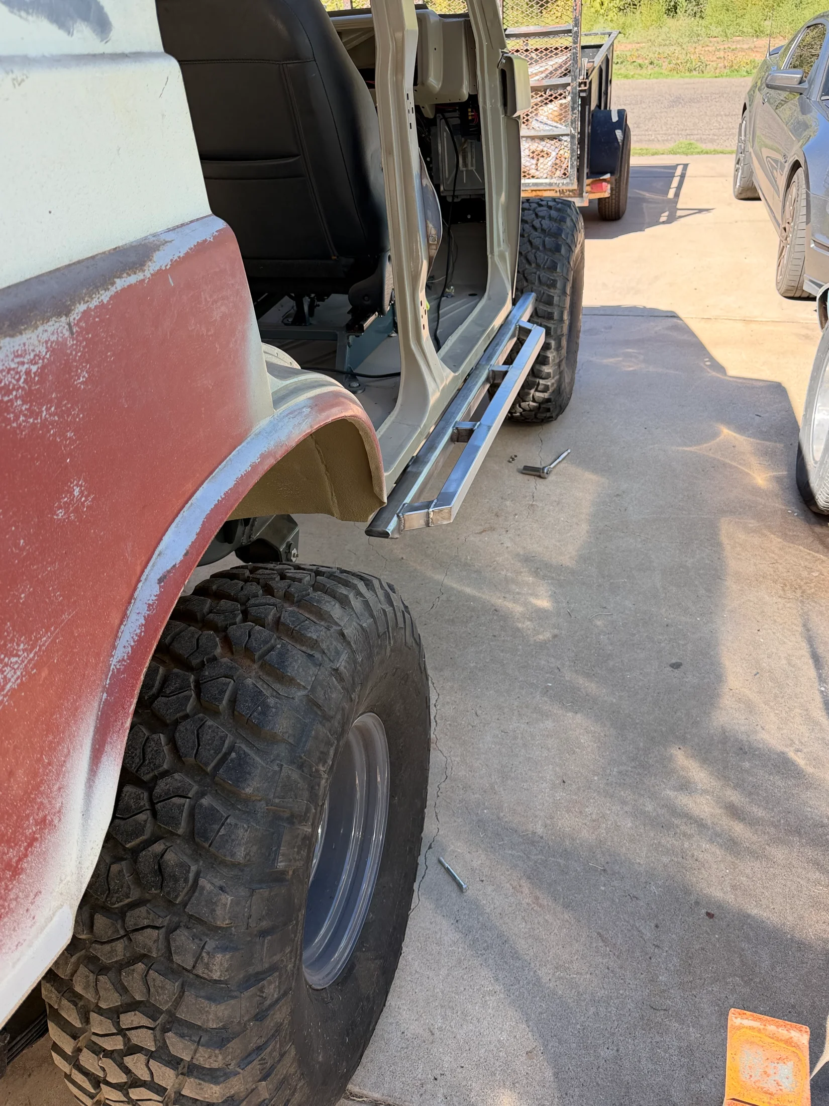

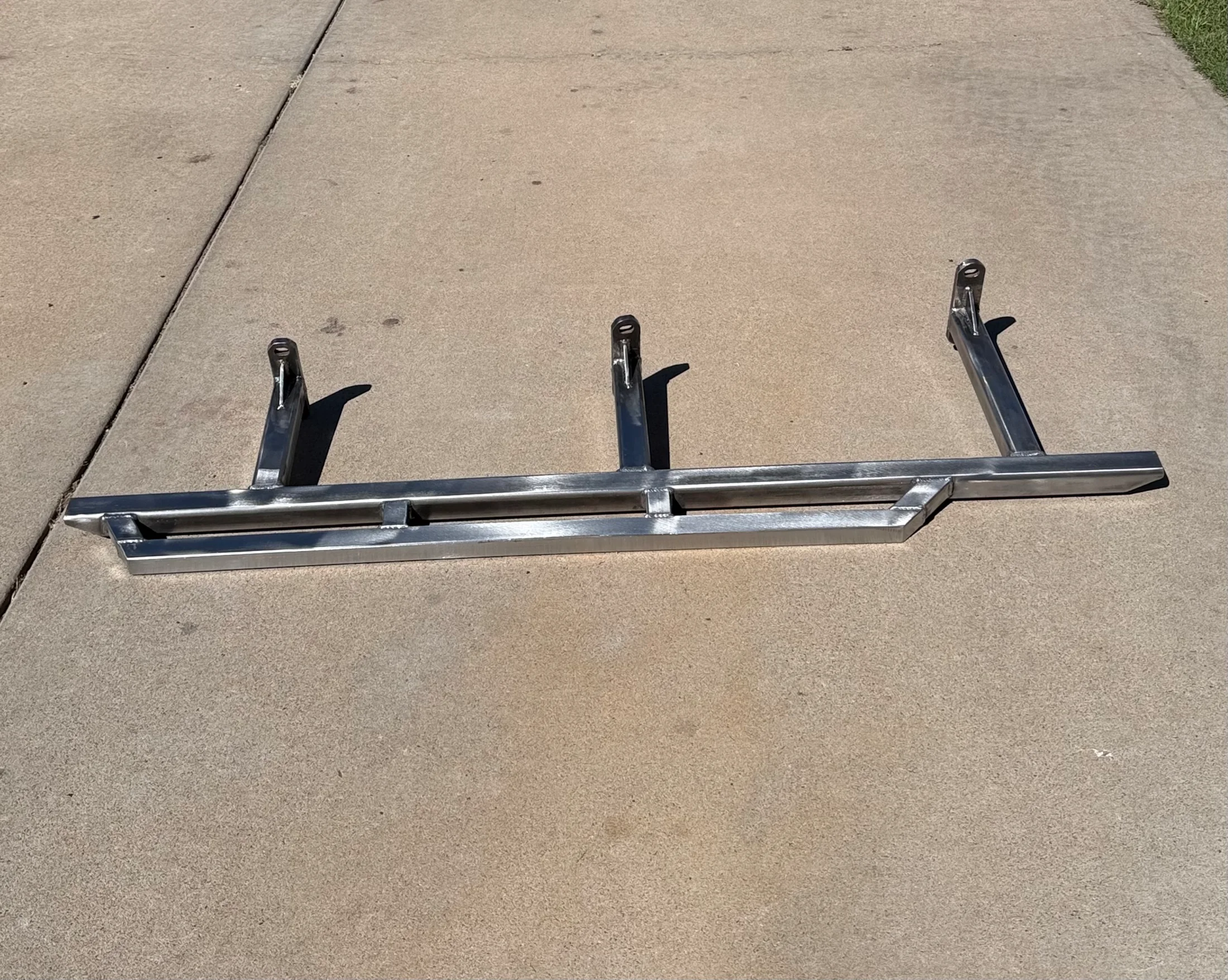

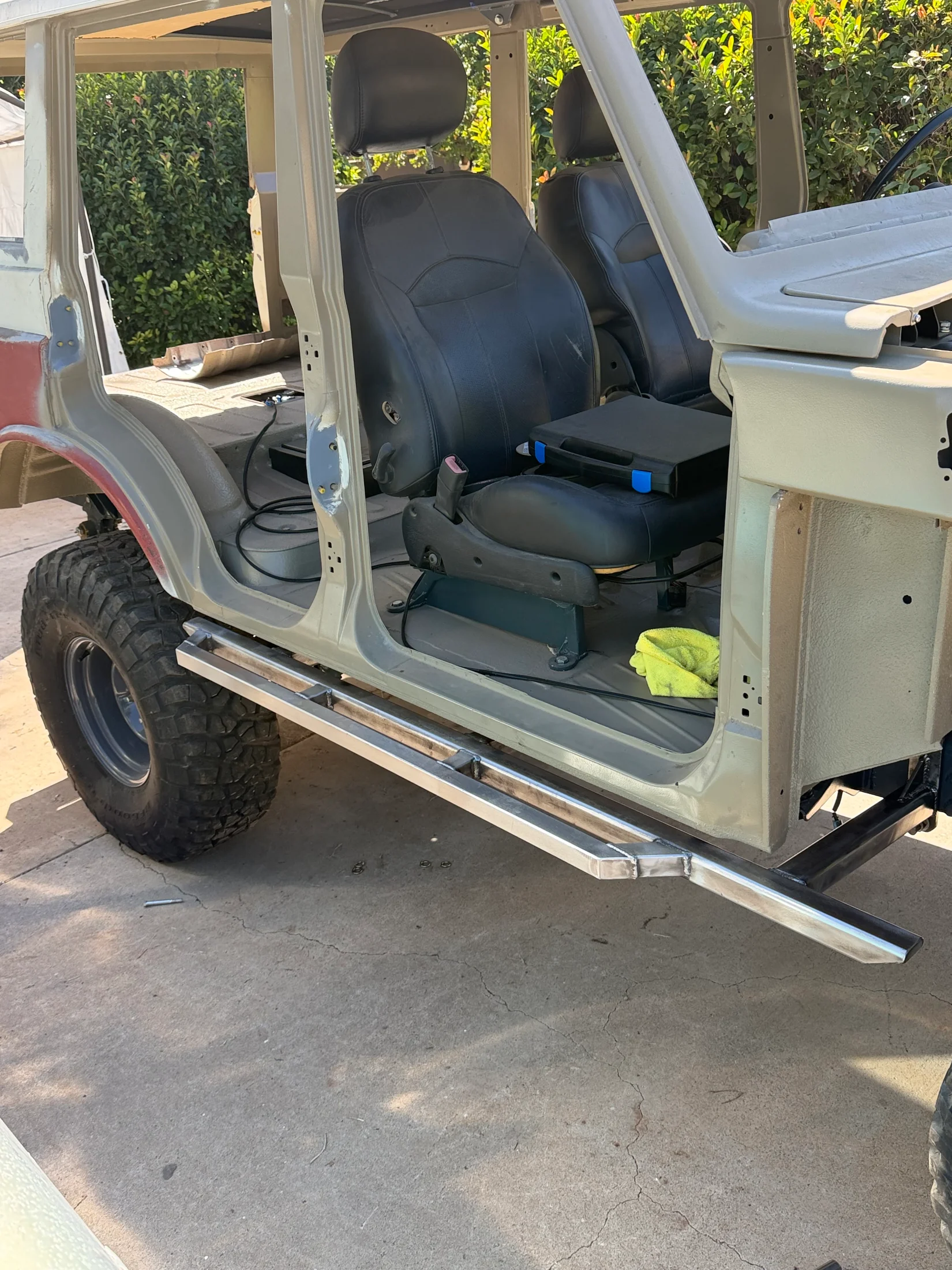

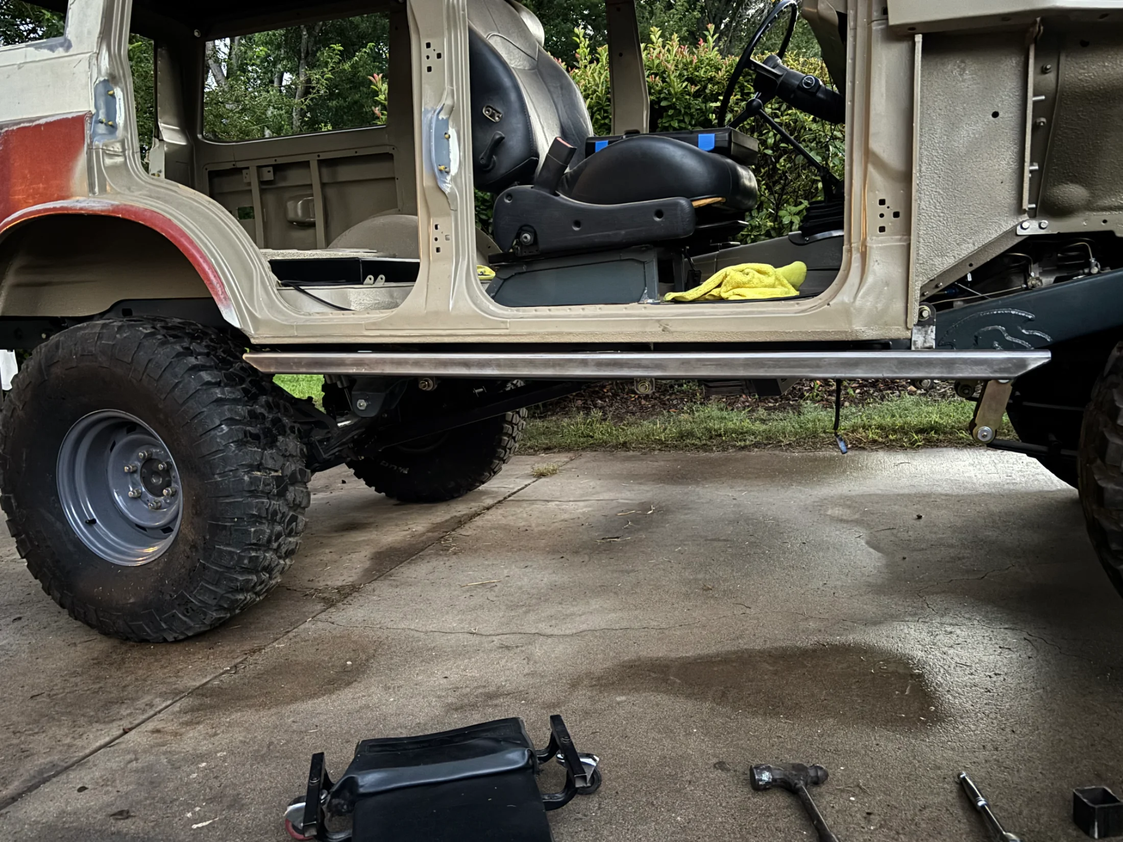

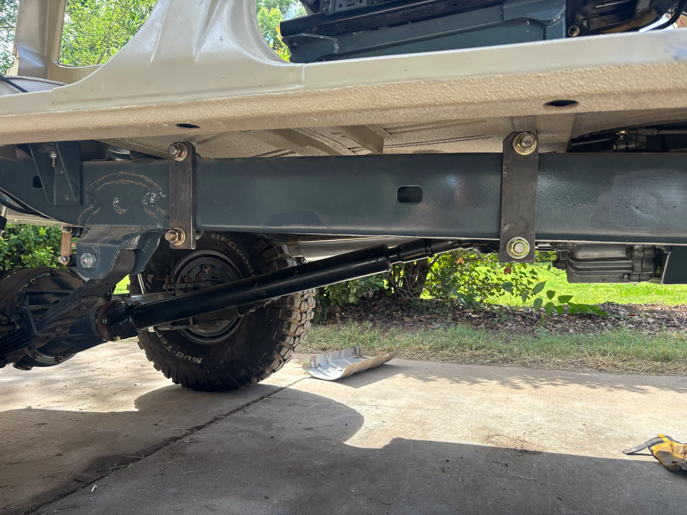

I have heard to have the support in different planes, as well, builds strength.
Absolutely, triangulating tubes from top and bottom of frame mountings would be strong and pretty to look at but given the small space and avoiding mud build up a simple plate gusset welded on the vertical is more than sufficient.
In my case I wonder if the small amount of deflection I get is as much frame twist as anything else

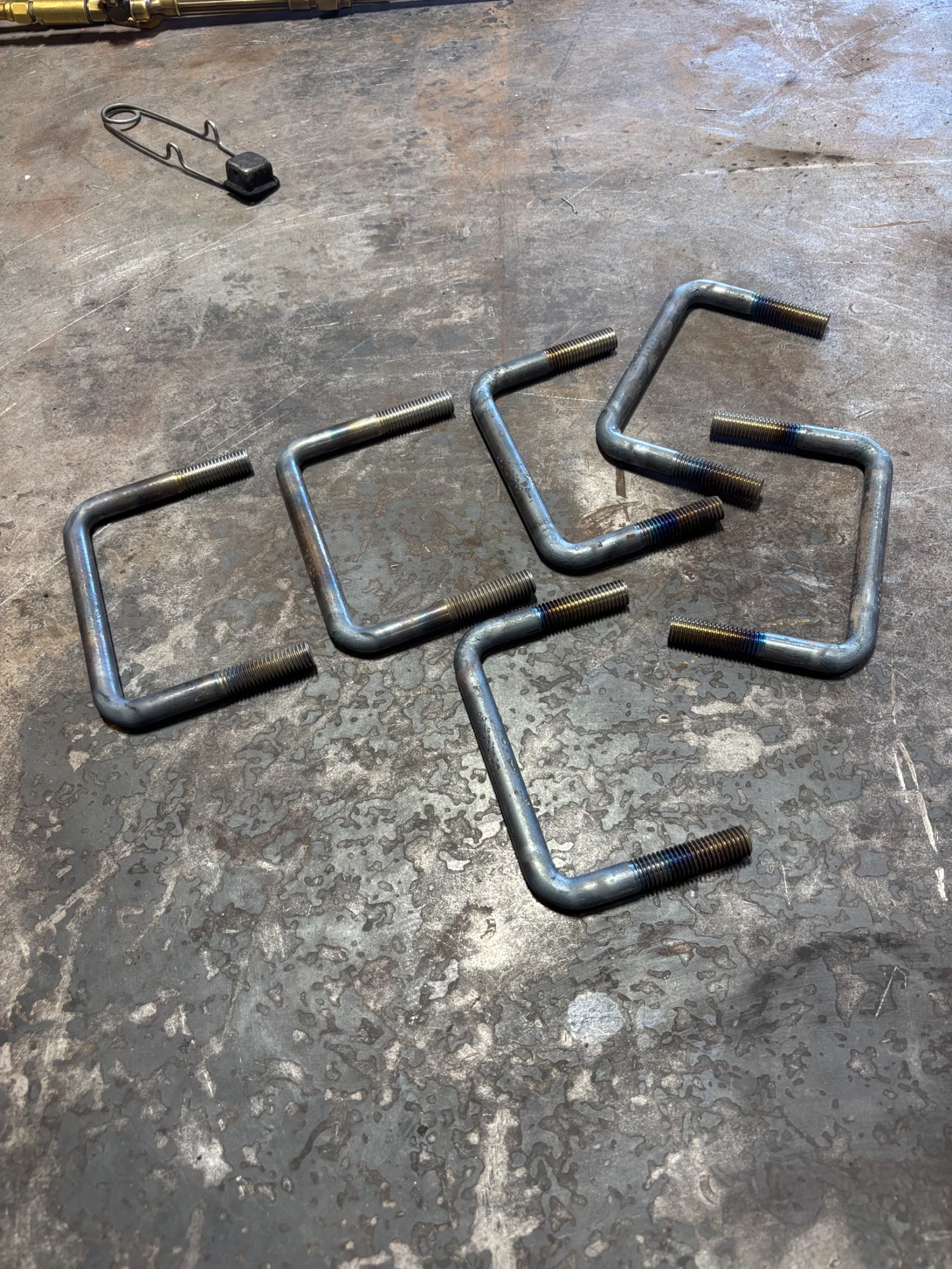

3/4” clearance
Beveled ends
Surface rust removed
