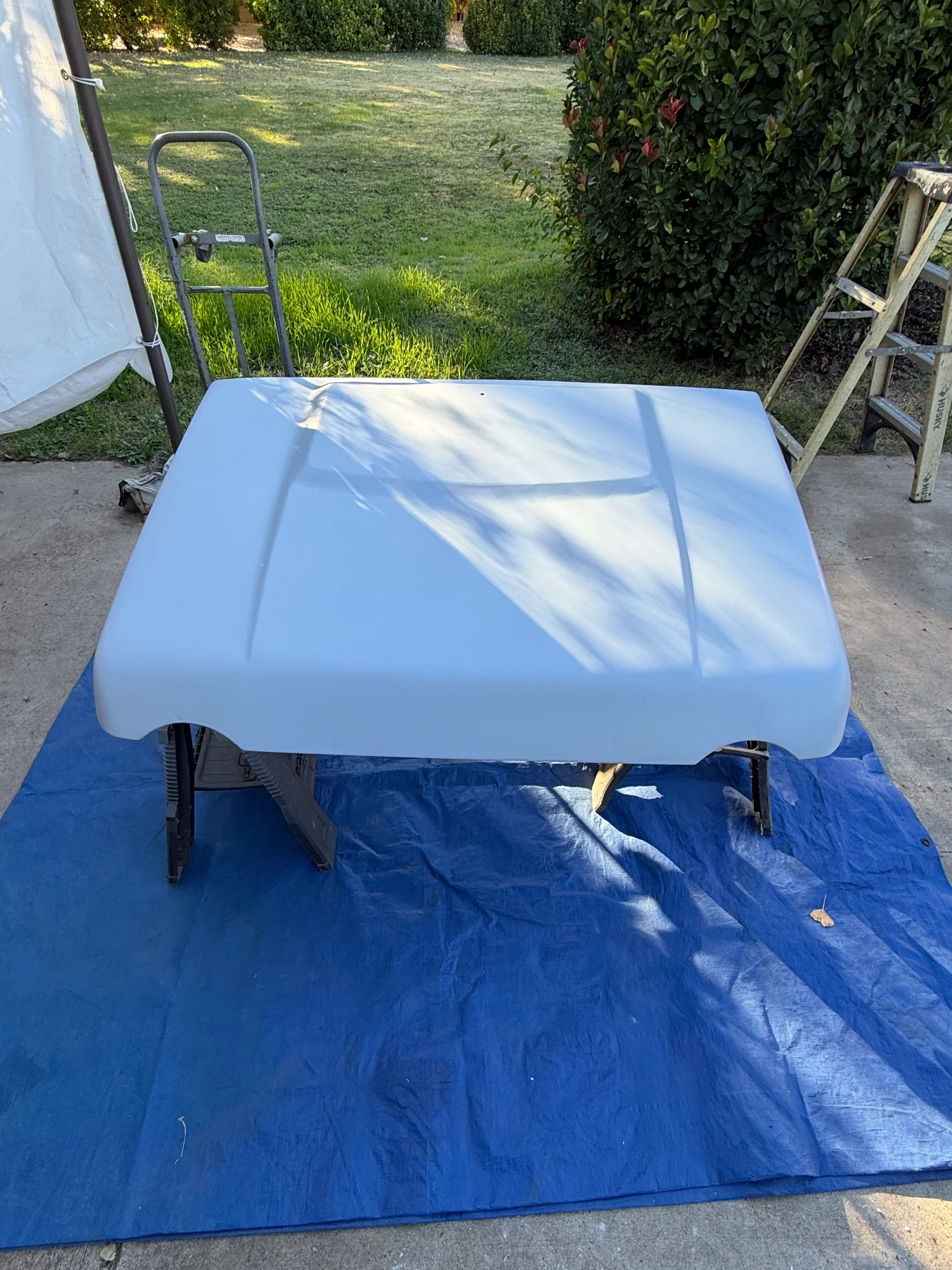

I got more done this weekend than I got done all last month. Still not as much as I’d like since the days are shorter, but it is what it is.
Epoxy primed and sprayed down first coat of 2K primer on the top side of the hood.
