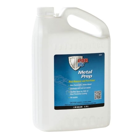

Slather on some type of metal prep solution and that will kill/stop any flash rust. Make sure it's compatible with whatever coating system you are going with. Most are a dilute phosphoric acid solution.

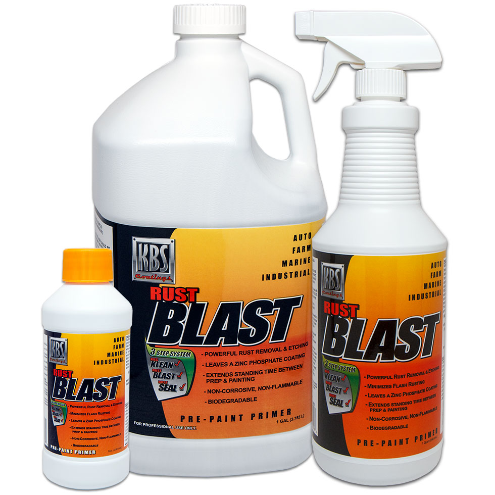

👍 yep. I usually use KBS rust preventative spray. It works well, but I still need to get in fairly quickly
That's different. That's an aqueous based rust preventative. It doesn't do anything for existing rust, which you may or may not be able to see. What I'm talking about is a metal prep product like these:
KBS does offer a similar product but I'm assuming this is not what you are using.
I’m using the rust blast set up. It does work, it’s just got to be applied straight away.
