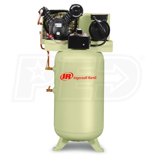

Upped my game a little.
Big ‘thank you’ to my bride and my sister for hooking me up for my birthday 🎉
Amazon sells a belt guard after cooler that will help make your life better, combined that with an auto tank drain and you're all set.
Belt Guard Aftercooler for 5-7.5 Horse Power Motor 3/4 Inch Female NPT Fitting
For those not sure what I'm talking about, The commercial version of that same air compressor comes with those two items already installed. Cooling the air before it hits the tank and keeping the tank drained will greatly reduce the amount of water in your system.. Ingersoll Rand charges a little over $1000.00 for those two items but they can be added to your air compressor for under $300
