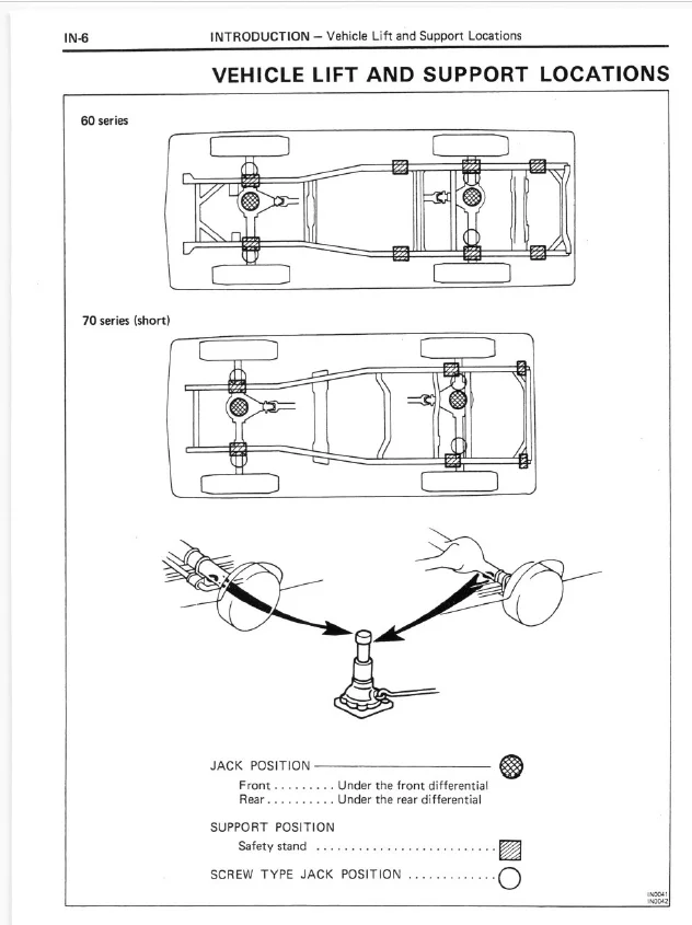

Looking for a good floor jack that can lift a lifted 2” FJ62 up high enough to get the wheels off the ground. Right now with the standard 3.5 ton I can get 6 ton stand under the chassis but the suspension droops enough that the wheels dont leave the ground. Looking for recs on a good floor jack that can lift this thing up.
I always used the Toyota mechanical screw jack that came with the vehicle. I had 3 of them. They are short enough to get under the U-bolt backing plate, or at least the bottom of the spring pack right next to the backing plate and lift the vehicle up plenty high for a tire change or whatever. And since they’re mechanical and not hydraulic, they’re super safe extended.
I lift from under the differentials so there is no suspension droop to worry about. It is uneven due to the offset location of the differential. I have also lifted from under the spring pack near the axle or if you have flipped u-bolts or a skid u-bolt skid plate, from under that location.
Once lifted you can put jack stands under the axle(s) or under the frame.
Ya I lifted from under the diff on the front but when I put a jack stand under the frame and let the diff/axel assembly drop down the tire touches the ground. I lift as high as the jack will go and the 6 ton jack stands dont get notched high enough. I didnt have enough room between the jack and the diff and the axel assembly to get the jack stand to seat properly. So really could only put a stand under the frame. Trying to get both front wheels off at once to drain the power steering using the pump to push the fluid out.
