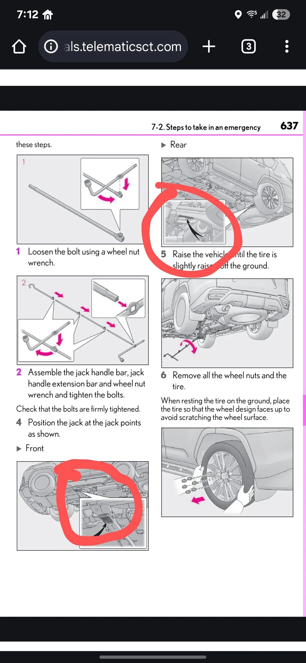

Have you guys tried to lift the 700h's front wheel using the jack point that the manual is stating?
I was trying out my new Daytona 3 ton jack super duty and using that jack point seems like its lifting a lot of weight of the car unnecessarily. So I'm wondering if you guys are using the same spot. I see that there's a spot on the frame, closer to the front wheel that may be better?
Here's what the manual is saying. Bottom circle is where the front point is located.
I typically jack from that subframe member as shown in the screenshot above, but I'll place my jack stands further towards the front of the truck on the frame rail.
