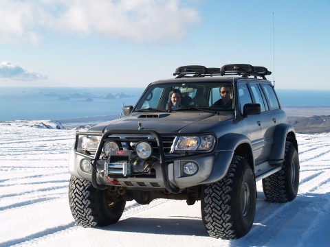

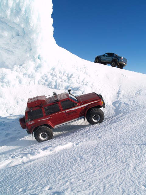

The Trolls in iceland are not big HP. They still just run a turbo TD4.2. Their mods are real big tires, a lot of cutting, suspension and gearing work. You see some of them crossing rivers and you would swear with those big tires they would float in the water. I think they are down around 2-5 psi and from what i have read they don't run beadlocks. They just carry lots of lighter fluid.
GU Troll
GQ Troll
Off course their paddle rigs would float nicely too but at much higher speeds. :cool:
GU Troll
Nice patrol by the way.
