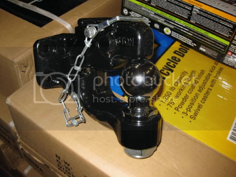

so princess auto has a sale on a combo pintle hook/2" ball receiver for 80 bucks.
and it fits bang on to my rear bumper on the 80...

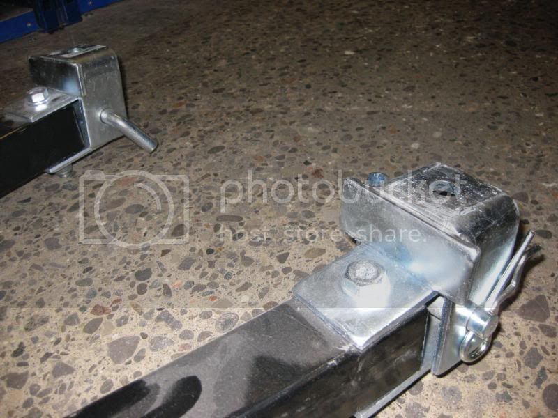

they have a flat tow bar for $160....

Look at the thickness of material used on the tow bar. You have a heavy 40 when trying to turn a tight corner, there is a lot of stress on the side sides of the square tubing. The steering has to run unlocked to allow the truck to turn. The other towbar may be $100 more but may also be heavier in material used. You should try to keep the tow bar as level as possible for the same stress reason. If you install a class 3 trailer hitch on 80 (excellent universal style at Princess) then you can mount the bar points on top of the frt frame of 40 and adjust your height with the receiver for the hitch on 80. I am also making up a tow bar system for Jakob's 62 to follow the Landblazer.

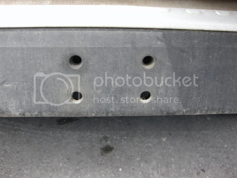

Check the 80 section for advice on the factory holes for that pintle to make sure it's strong enough.
first, the hitch mount on the rear frame is plenty strong enough.
the tow bar mounts MUST be stright out the front, not top, not bottom.
the tow bar is plenty strong enough.
