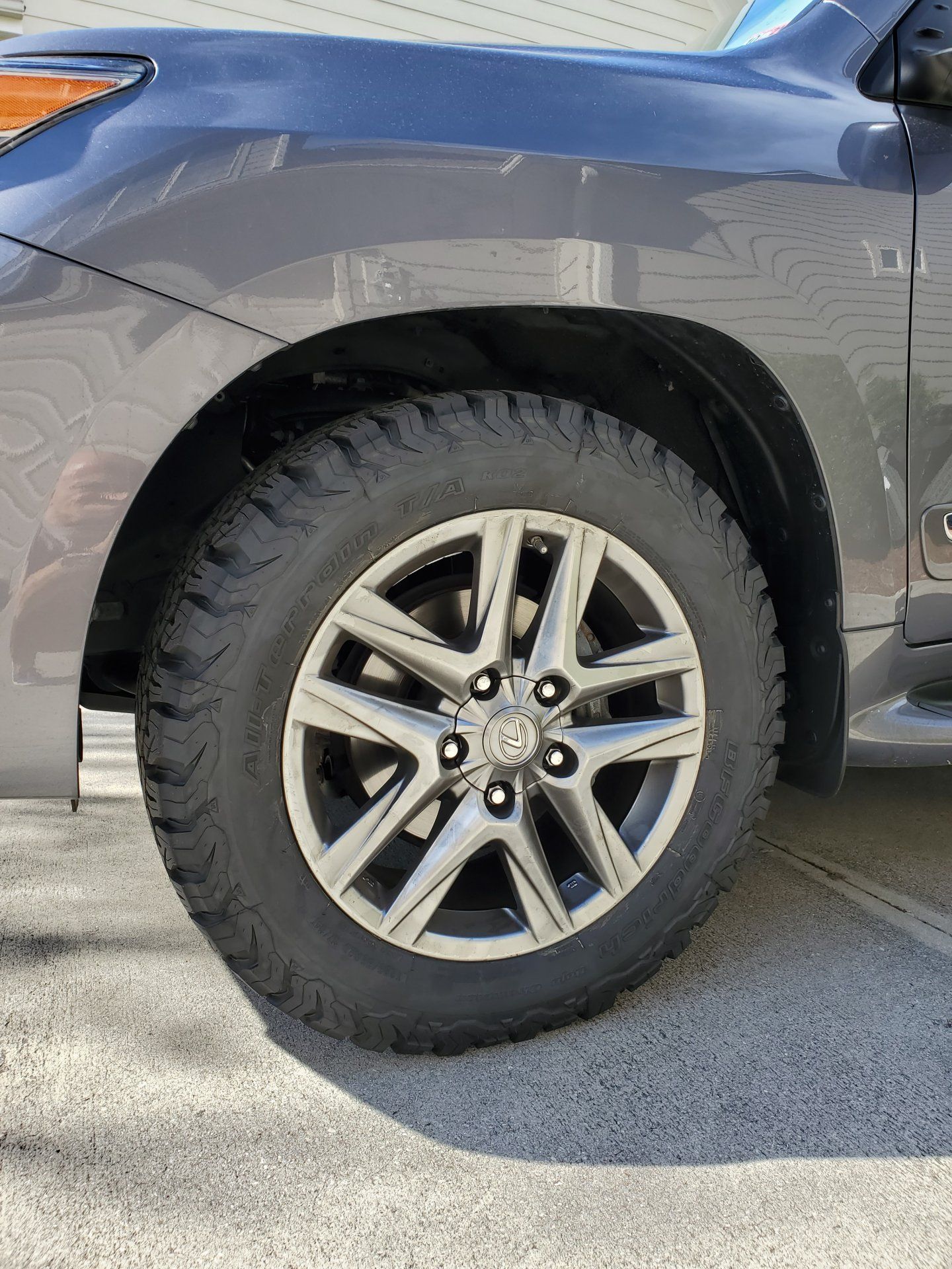

I had 285/55/20 BFG AT KO2s installed on Friday and this reinforces my opinion that BFG ATs should come stock on Land Cruisers / LXs. They definitely increase the "planted" feeling of the vehicle. I'm running 42 PSI, had no issue fitting the spare, and they balanced out really well with just a few ounces on each. We immediately road-tripped on Saturday and knocked out 500 miles, smooth as silk.

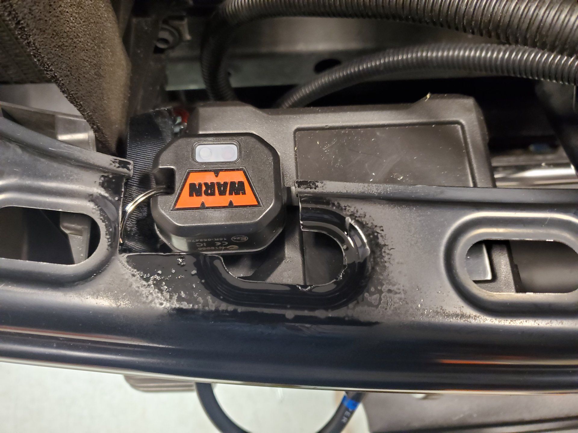

I mounted the XPS with the remote transceiver in place, this required "modifying" the front valance support bar. I marked the bar and allowed for a 1/4" off space around prior to cutting with the reciprocating tool. Once cut, I deburred the edges, sanded, and primed and painted to minimize the chances of corrosion.

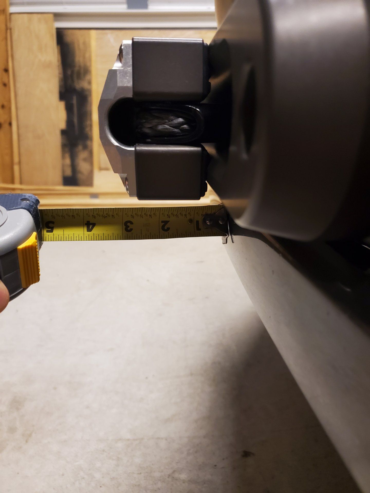

The fairlead, Flatlink, and Rope Protector only stick out about 3.5" from the front of the bumper:

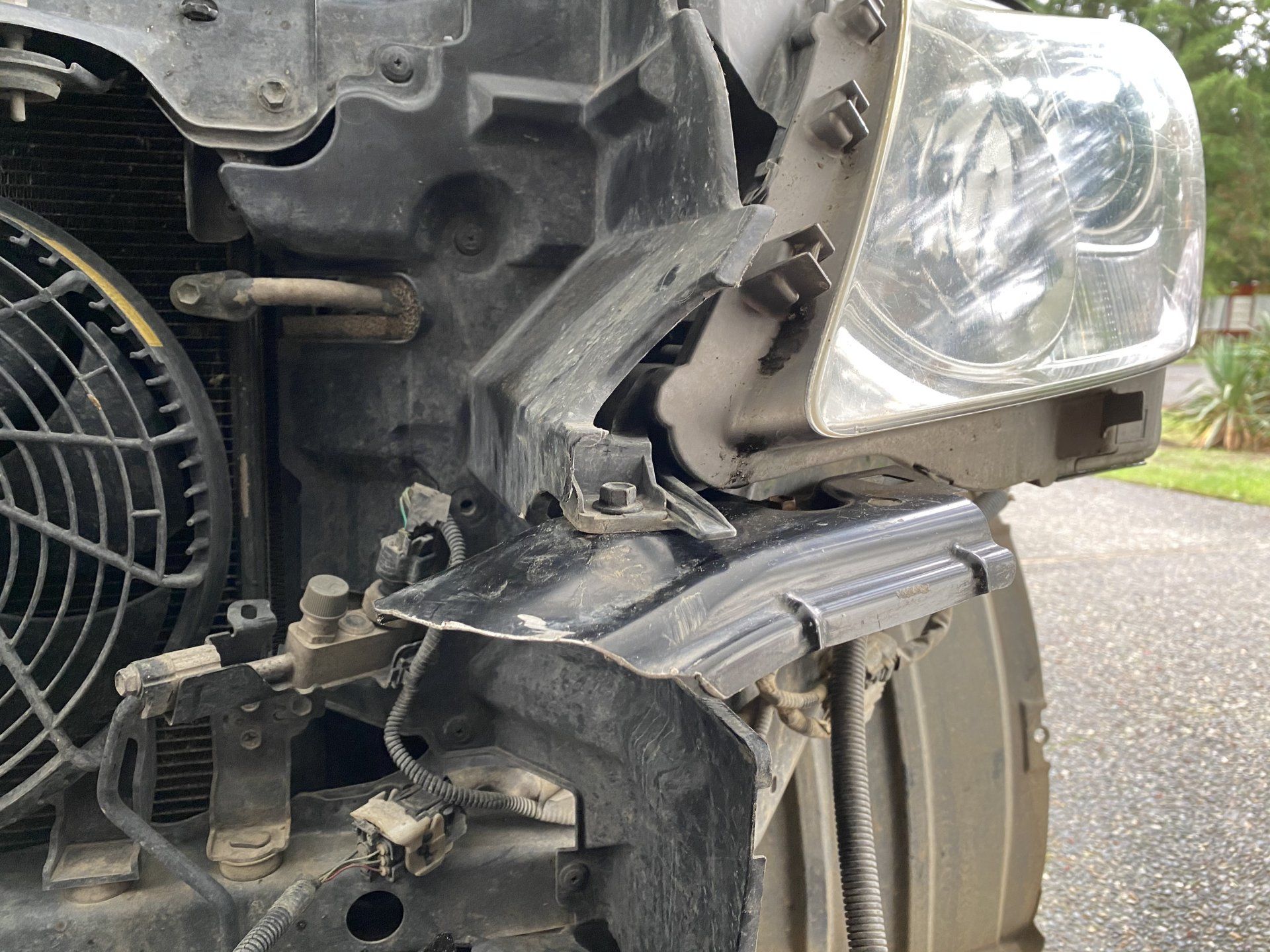

The grill support attaches to the body via an L-shaped bracket. I left that plus enough of the support to hold the headlight. It’s rock solid.
Here Is a shot before I cut. You can see that the grill support makes accessing the winch clutch really difficult:
