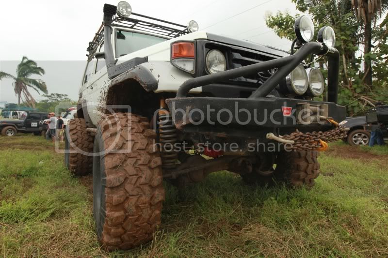

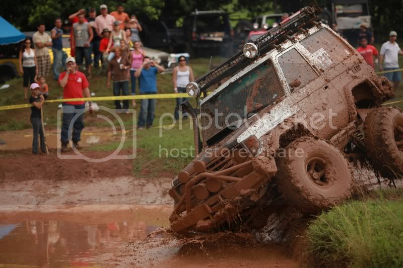

Any more information on that truck tapage?
shortened 80 series frame, 80 seres axles with 6" slee suspension, 1HD-T engine, top mounted intercooler 4.88 R&P ARB lockers .. etc etc etc ..
@Tapage
Can not find the email exchange with this info....
What were the tire and wheel specs on that?
Wheel back spacing?
those are ( were ) 39.5 TSL in 10" wide wheels with 4.5 backspacing ..

Hi Tapage! can you tell me the wheelbase for this 70 series, and which trans it runs ? h55?
Thanks!
Wheelbase was stock 70 series ( he didn't stretch body ) and tranny was H151
