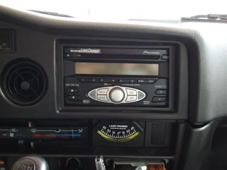

x3 on the Scion radio. Can't beat it for the money and fit...

Which year are we talking for the Scion radio? I'd been looking for something to fit in my 62.
Try using search for specific models. Mine is a 04 but others will work. It's a direct replacment mounting and wiring wise. All you have to do is modify the face plate of the radio a bit - taking some material off from both left and right sides to fit the 62 dash opening. 10 minutes w/ a Dremel tool and you're golden.
