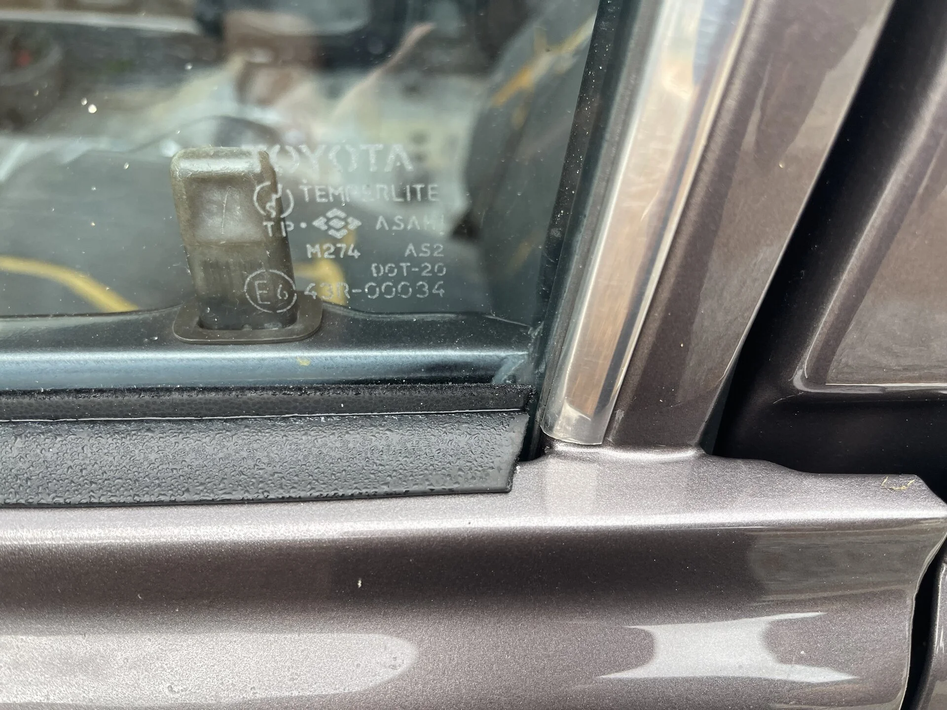

I bought these from City Racer and had them installed by the guy who painted my truck.
My question is did he install them incorrectly? Cut them to an incorrect size or break them?
I bought them to seal the windows but as installed these are doing nothing to stop the water intruding into my doors when it rains.

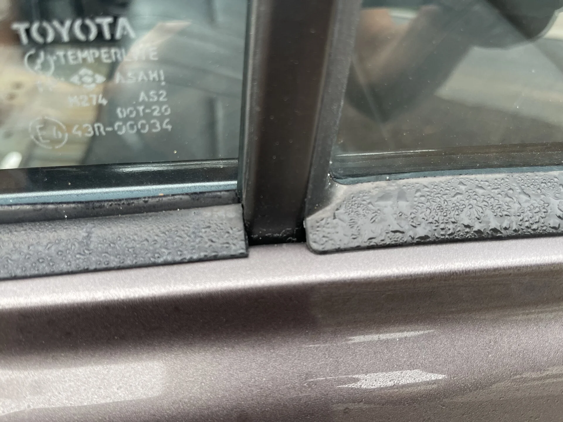

My felts from city racer looked similar. I don’t think they actual seal the rain out, as my stock ones that I removed where also similar in lack of coverage. There’s drains in the bottoms of the doors and a vapor barrier, probably for this ill fit.

Our vehicles have what are referred to as "wet doors" in the auto industry, or something like that. That term applies to a lot of different cavities in a vehicle such as a pillar or sunroof drain style.
These doors are designed to have some water get in and drain out the drain in the bottom. Keep your drains clean and some fluid film in there. You'll be fine. Think about how perfectly the rubber would have to fit and sit over time without shrinking or shifting to keep out water.
