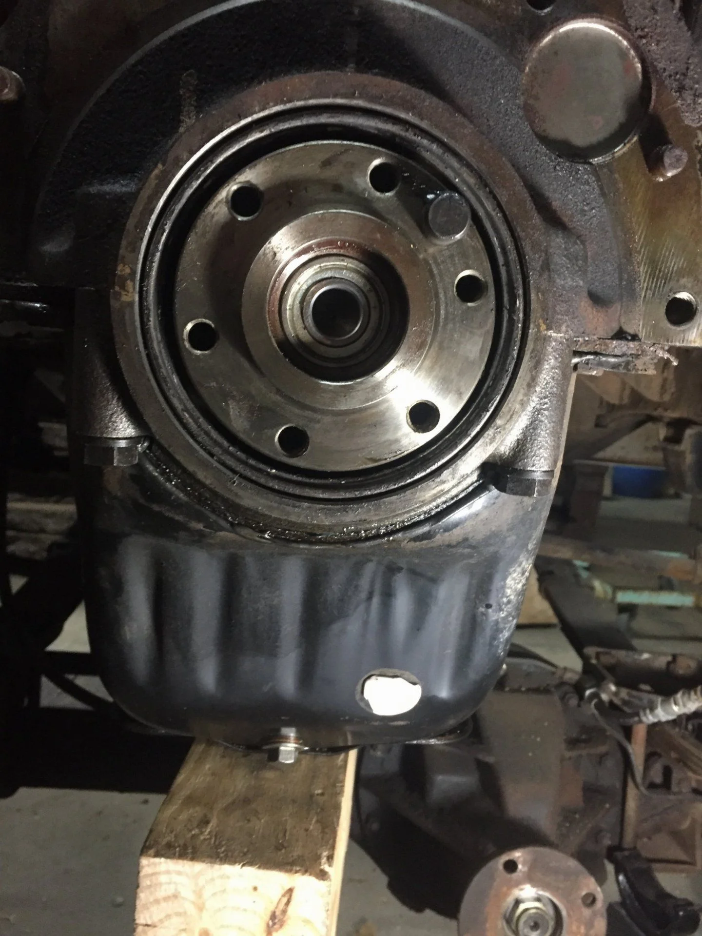

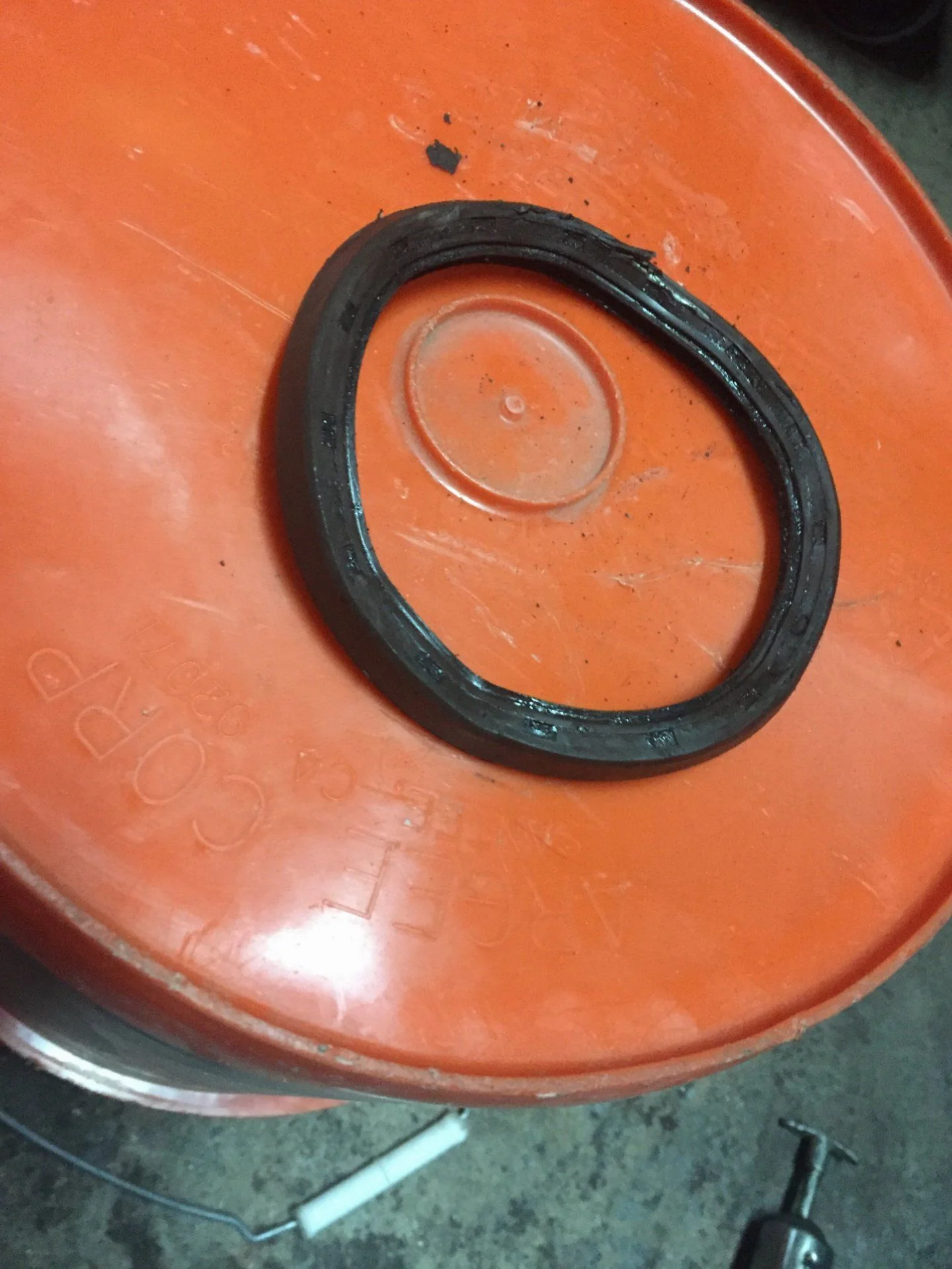

I used a beck arnley brand seal.
Ok, I guess you can't help stupid. I pulled the oil pan and rear bearing cap and out popped this ring of metal ( that I thought was part of the housing back there.). Turns out it was the inner ring of the RMS. The old one was so degraded that the rubber covering had come off, leaving the metal ring behind. So while laughing at my stupidity for the rest of this evening I got the new seal in, oil pan back on, bellhousing and clutch back in.
Thanks for all your help with this noob folks!! Once again, can't help stupid lol!!
You sound like my level of mechanical knowledge. I have to do exactly what you have done. My question is did you rebuild your transfer case or just disassemble it and reassemble it on the new transmission? Did you get a gasket kit for the tranfer case or put it back together with black formagacket? Thank for any advice you can give me.View attachment 1417994 View attachment 1417993 Ok so after completely destroying my rear main seal trying to get it in are there any tricks to this!? I used a pipe the same diameter as the seal and it just wasn't going in!! The outer diameter of the seal just seems about 2 mil too big. Here are some pics. Any help would be greatly appreciated as this, believe it or not, is the biggest hangup so far on the tranny replacement.
Ok thank youIf you need any help on the rebuild let me know. I've now pulled mine apart about half dozen times and put it back together due to different issues I ran into during either the rebuild or the original install to the new tranny.
No. Not me. Had to do it twice. Drop the pan and the rear bearing cap and place it into position. We ARE talking about a Rear main seal right? Not a gasket.Have other folks had success not dropping the oil pan and sliding a new OEM gasket in (@TRAIL TAILOR @60Works)? I know the FAQ and write-ups say to drop the oil pan, but it's really appealing to just not do that (especially with my current build garage setup).
