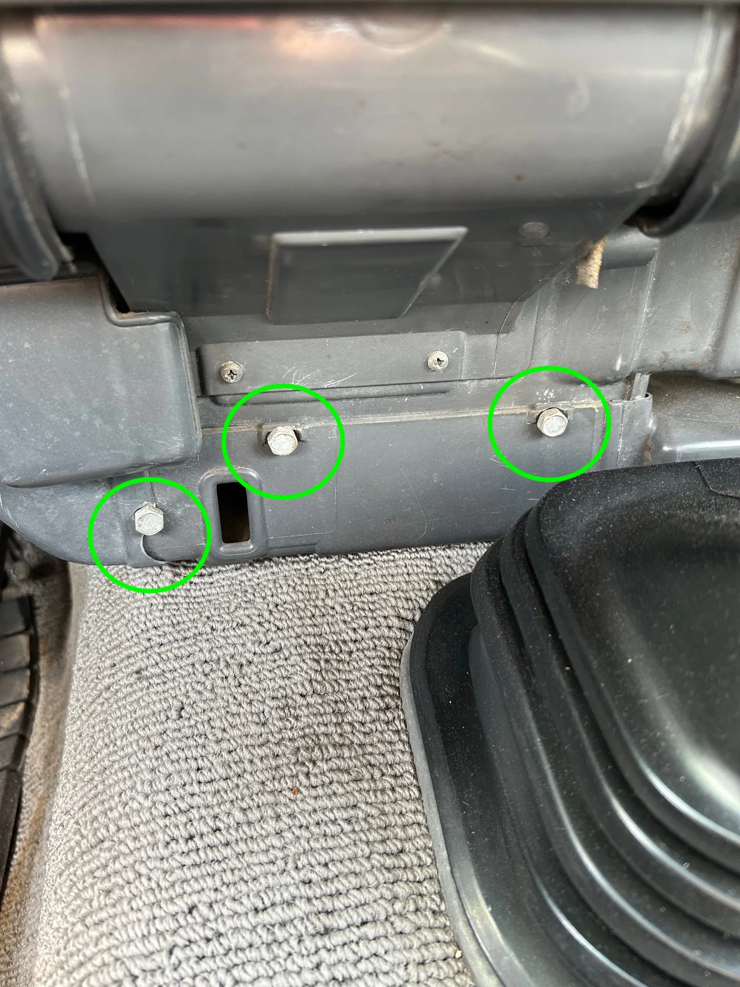

Does anyone know what the Toyota Part #s are for these bolts on the FJ60 vent system below the dash?
Thanks so much,
-ibis1969
They are supposed to be small self-tapping screws, not huge bolts.
Depends on the year.
Up to 11/84 the catalogue says they were spall self-tapping screws, 93566-54514.
From then on they were plastic rivets, 90467-05031.
I doubt the screws will fit after that bodge (those oversized screws were probably put in there after some genius overtightened the originals and stripped the material out) but you might be lucky with the rivets.
