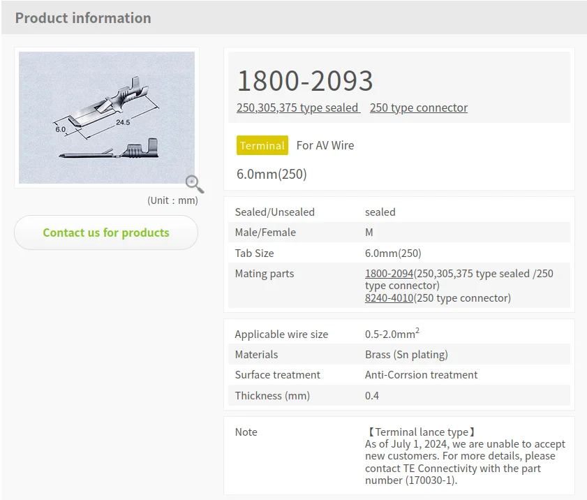

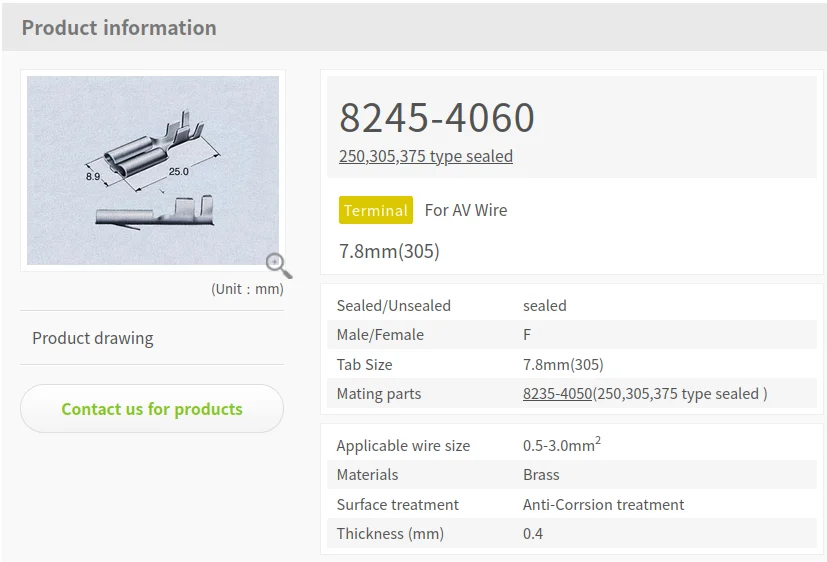

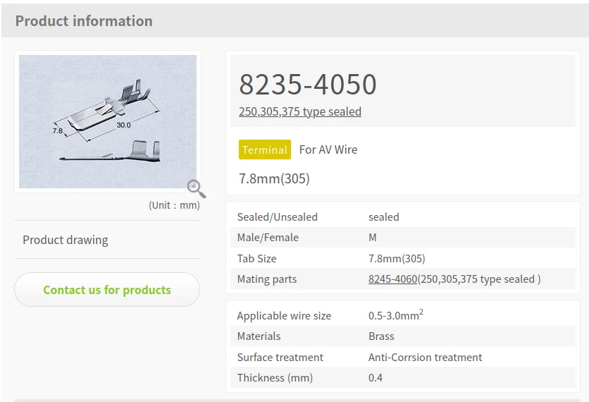

I found USA stock for all of these. I ordered enough to do some extras. If the parts are good quality, I'll post where I ordered them and the stock numbers.
