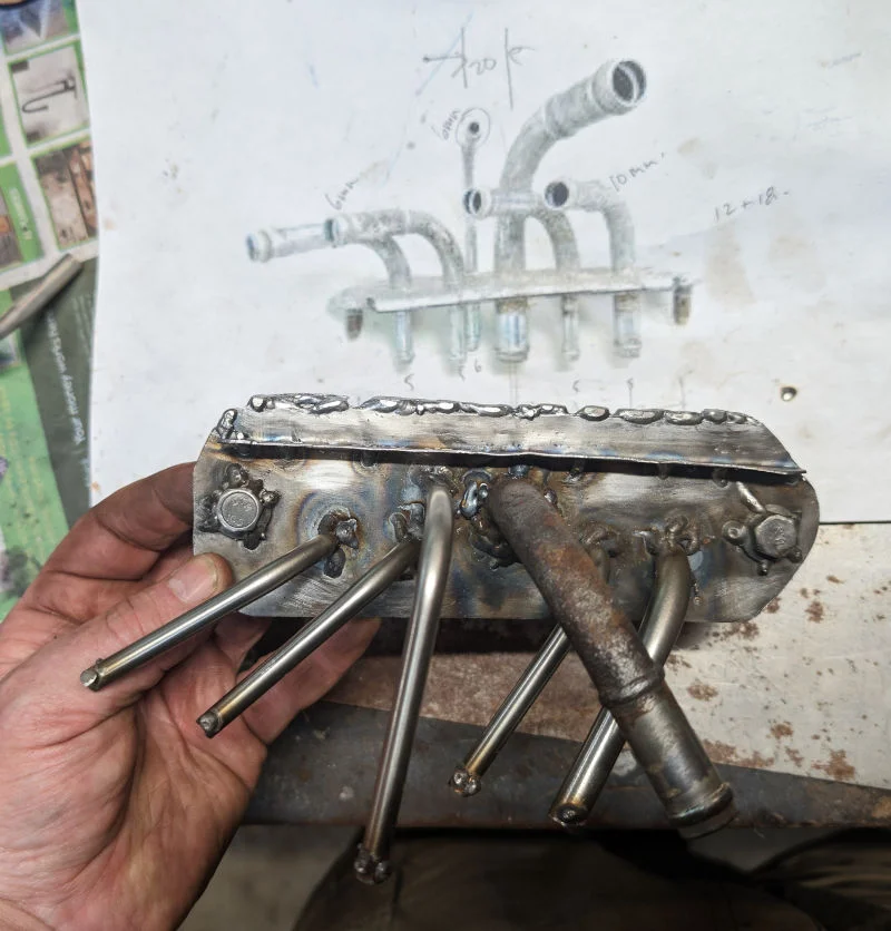

The connection in question can be seen here: took this photo from another thread and it might be an FJ62, but the "fuel connector" seems to be the same and that is exactly where my leak is occurring - on this side of that part.

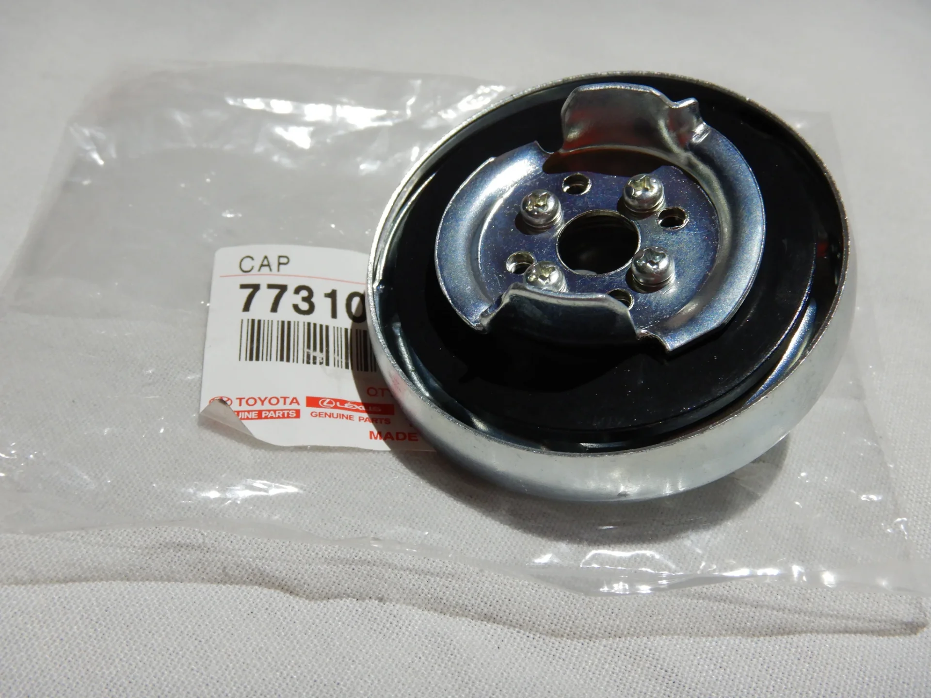

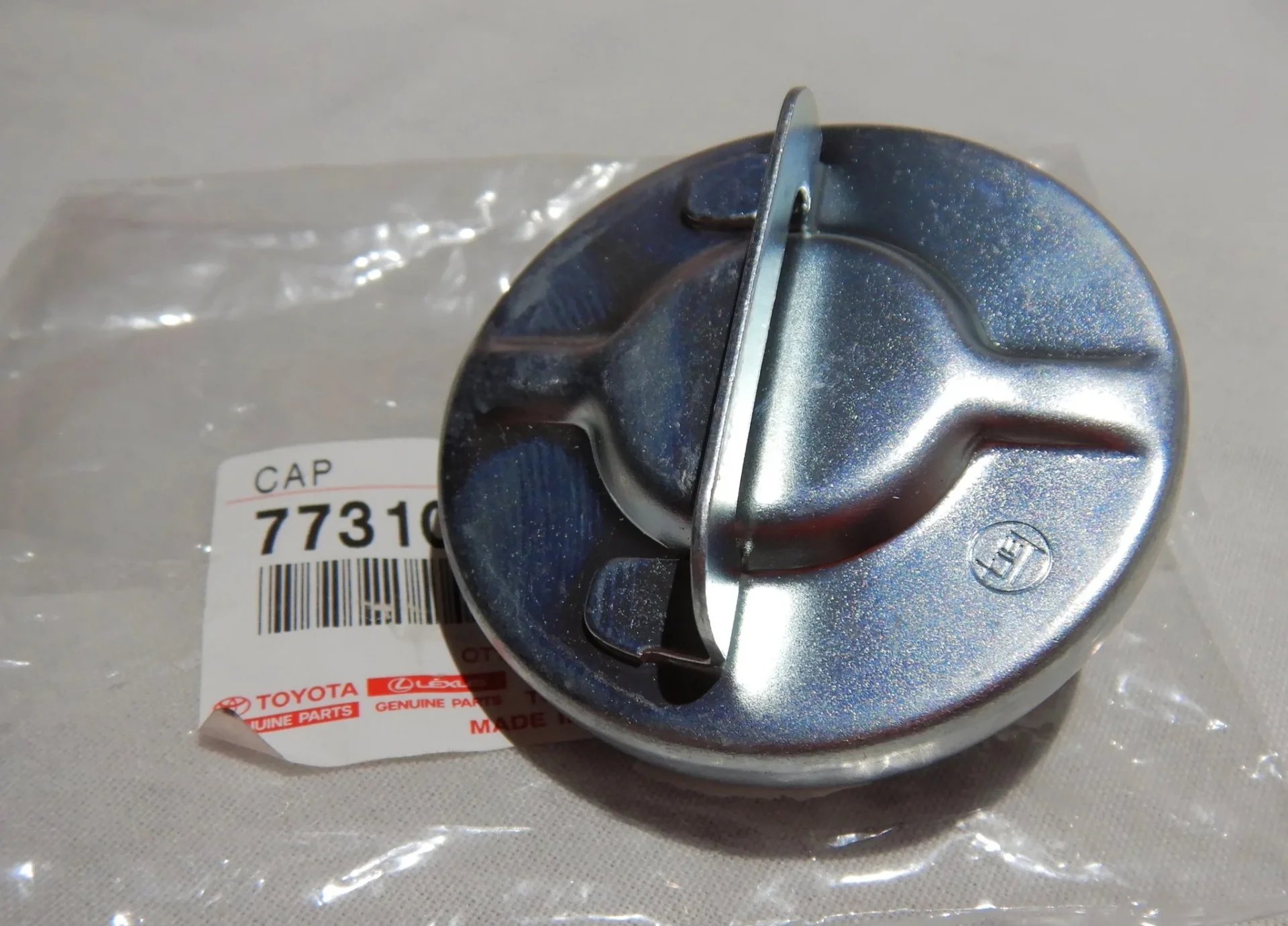

Curious
are u running a OEM toyota genuine parts factory GAS cap
or
aftermarket one ?
OEM LINK Example Below :
OEM Teq Stamped ones are 100% VENTED one way only , Inward NO exit Vents .....fyi
i have personally seen many many aftermarket pep boys walmart gas caps aftermarket cause issues like this , and a NEW OEM toyota genuine parts cap like below solve many too
its a low cost ZERO labor time solid starting point if infact u do not have a factory cap Teq LOGO stamped Exactly like u see below .....
No Teq NO Go !
Keep it Always 100% OEM and Keep It REAL :cool:
good luck :)

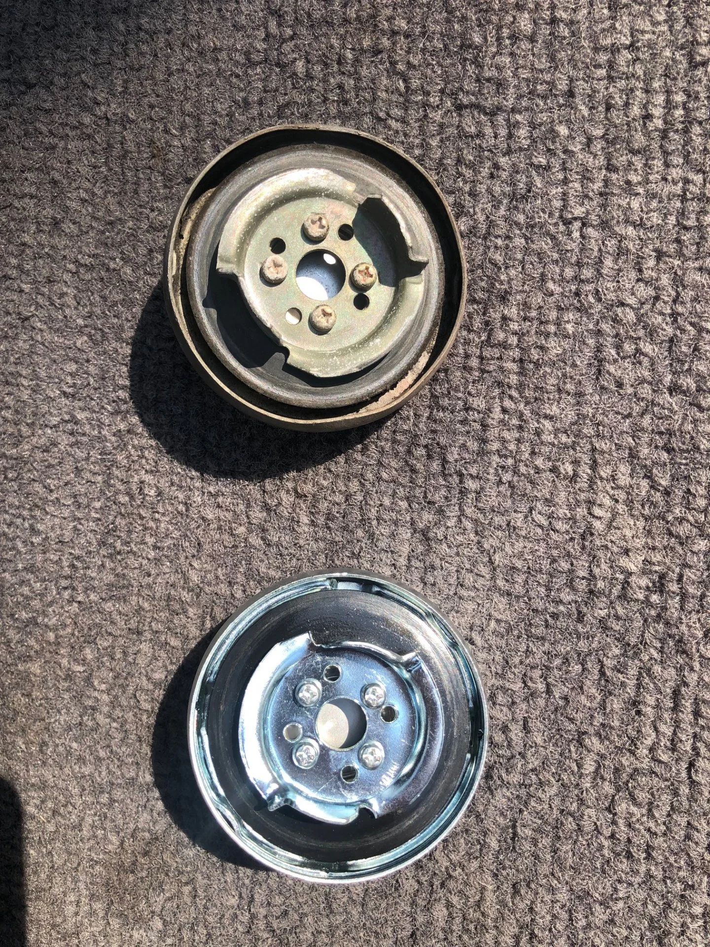

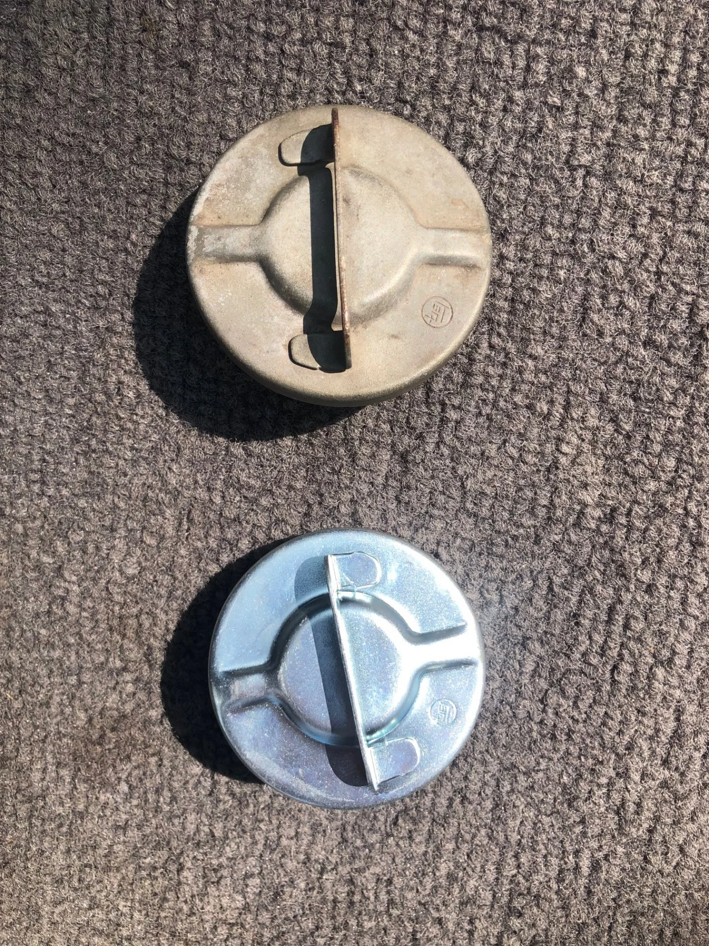

Hey @ToyotaMatt.
Thanks for the note.
So I think both the original and the replacement cap (that arrived today) are OEM original parts - factory stamped and bought under the 77310-12100 part number.
I purchased the new one from vintageTEqParts.com ... see below for photos of each. Do you think the TEqParts one is fraudulent/ not venting?
As you can see the rubber grommet was wearing thin on the original one...
Testing done today: I drove with both the new cap, the old cap, and no cap for each about 4-5 miles independently and was still getting the same fuel leaking affect... liquid fuel running down the inside and outside of the fuel/vapor connector plate.

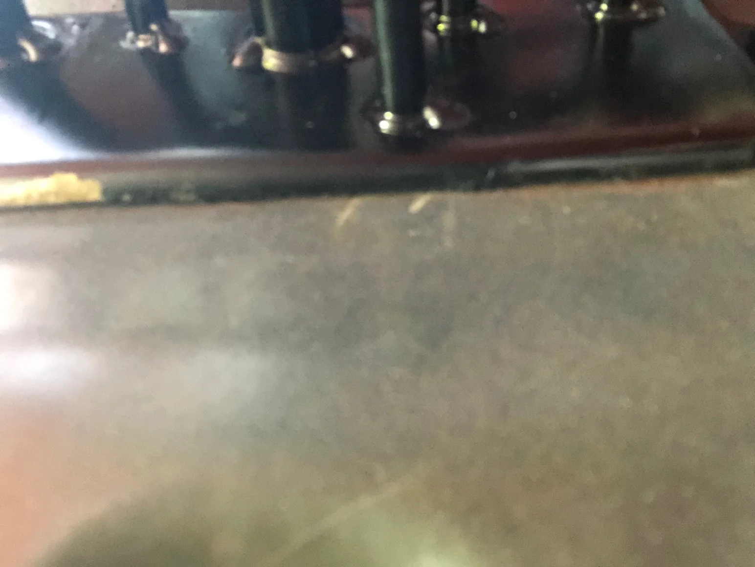

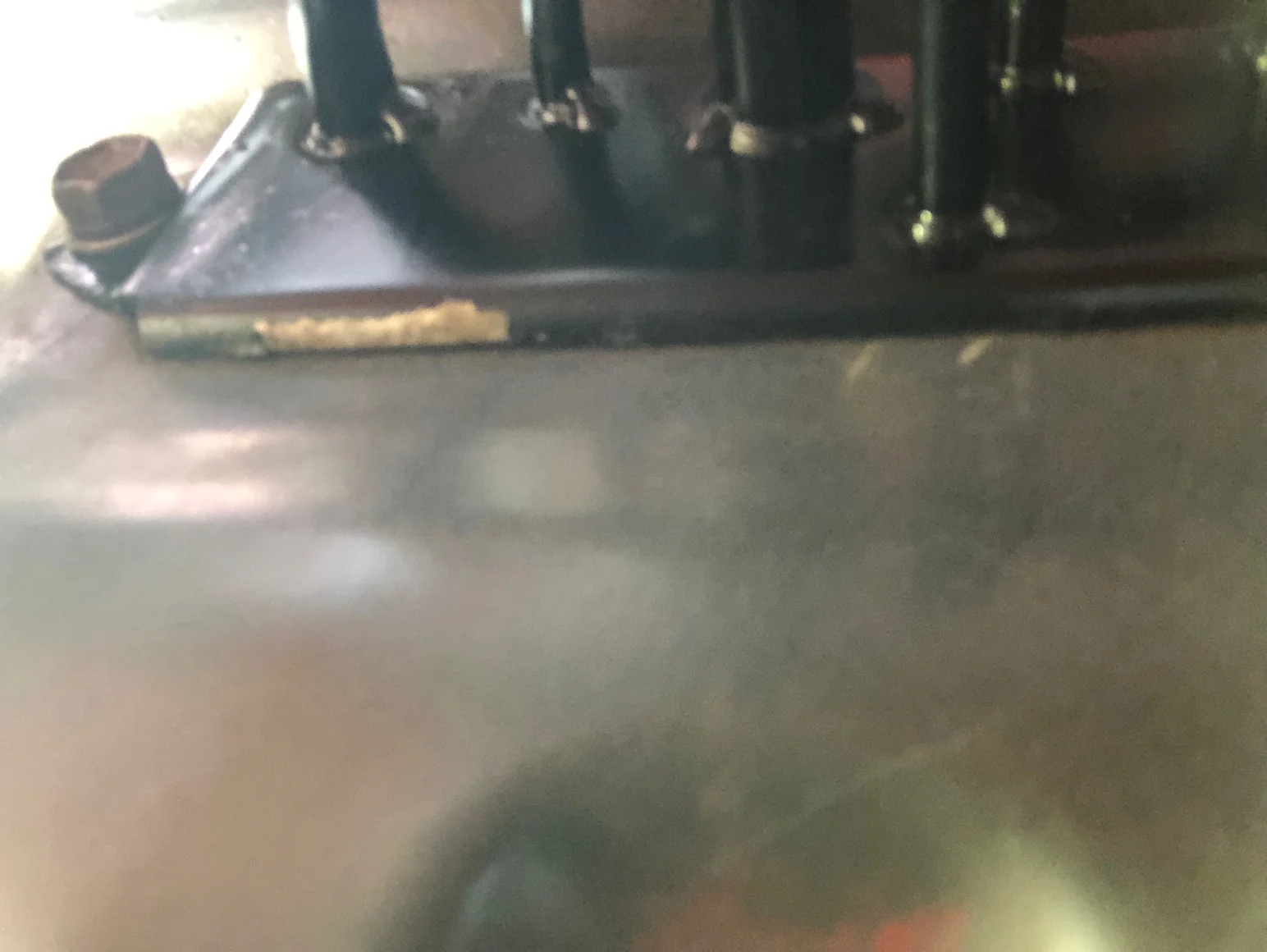

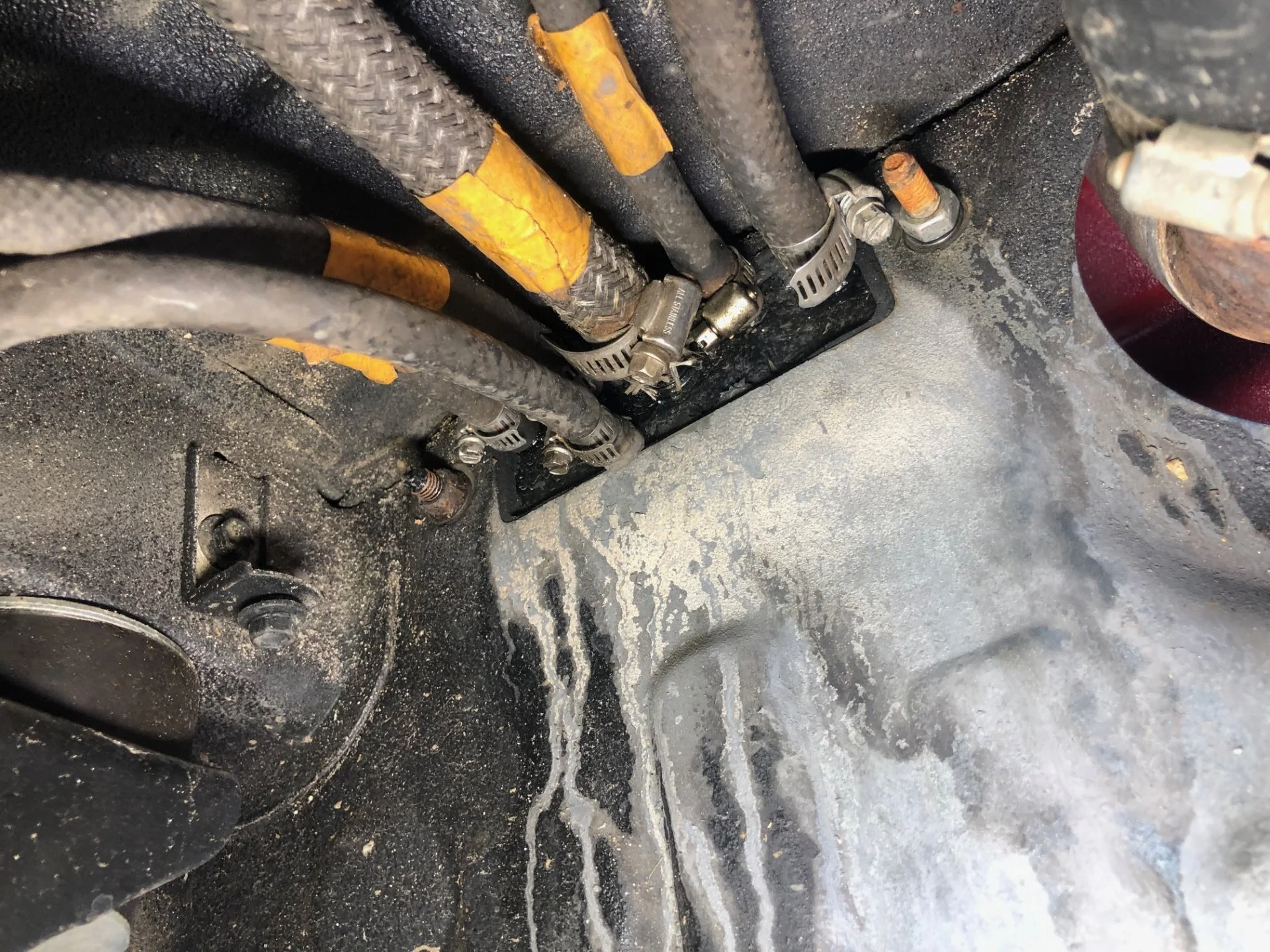

I think I am zeroing in on some vapor clog/ pass through issue at the fuel connector plate. As you can see from the photo of my under-side, there is pretty clear residue from where there has been leakage, primarily on the right side of the fuel connector plate.
First photo is under the vehicle where you can see the residue from the fuel leak. Second and third are inside the quarter panel shooting up at the underside of the connector- sorry for the grainy quality. There is also fuel wetness inside of this panel as well as on the exterior.
Any thoughts?

Upon closer review - the stamp is on the opposite side of the handle weldings and the stamp does not look as deep... or am I just seeing things?
