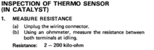

If it tests, I'll take it Ian.
With it out, I'm not sure what temp to bring it to before measuring.
Mr. @Spike Strip ?
Measure at Room Temp. If there's a reading (the good ones I have measure under 1000 ohm) ... What you don't want to see in no reading at all or VERY high. The resistance will decrease as heated.
I have also just held a BIC lighter at the tip to see if the resistance changes ...

Well, that beats the 0’s I’m getting.
