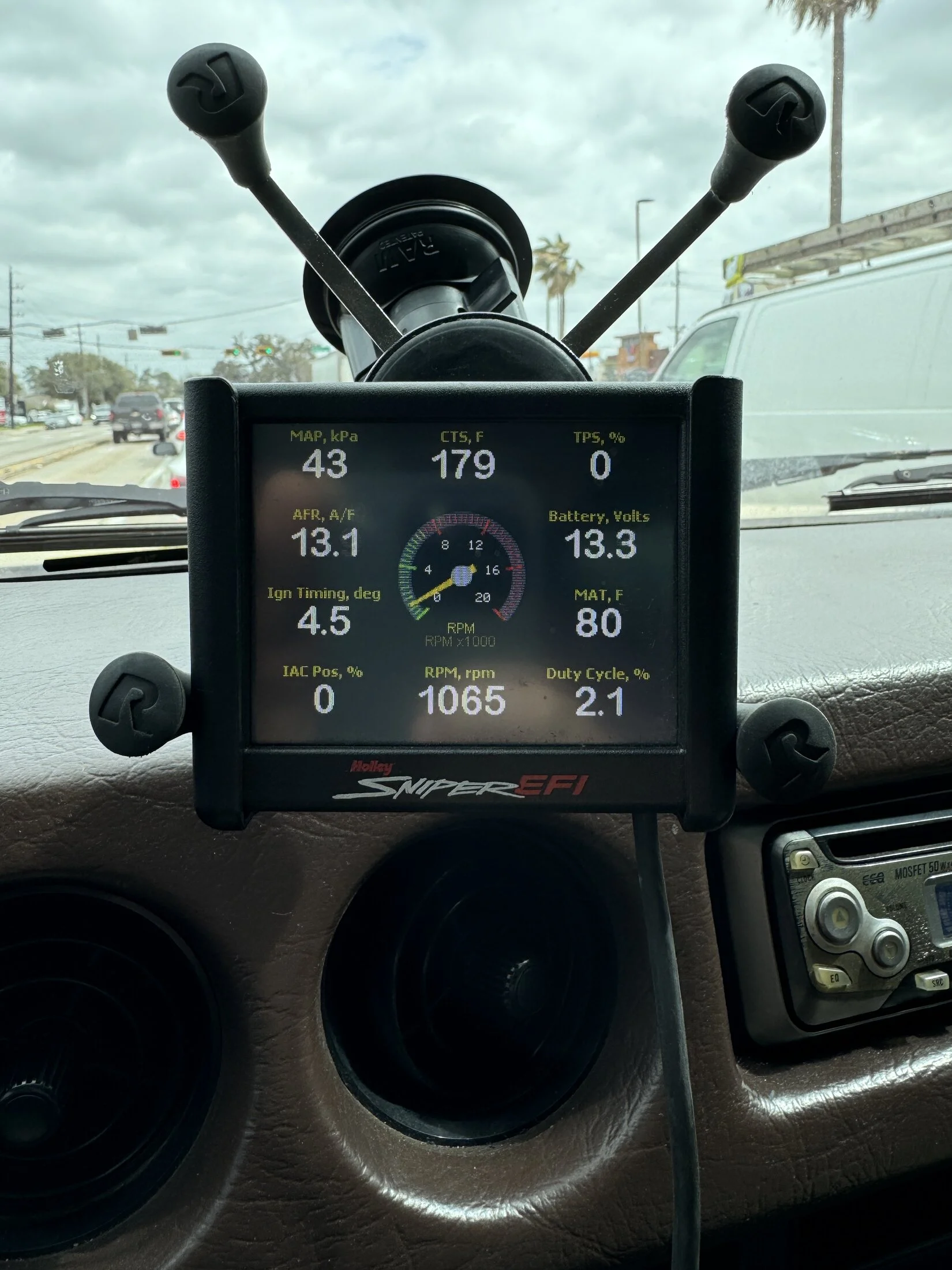

If you're referring to the monitor, i did take this picture while stopped at a light. The IAC% and TPS% are at 0..?
