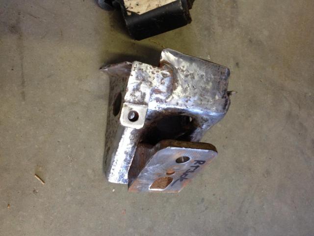

Went ahead and cut the 2f mounts off of my fj60. Looked good! Spent a whole day cleaning off the rusted trash metal from the junk mounts I got robbed on. Made them look better at least. Decided to test fit the 12ht with the mounts and maybe just weld extra support on them BUT!!!!
with the motor in the mounts won't line up. to the frame. Tried several different combos with even a 2f mount on the pass side.
Called george in a panic, set the motor on the axle via 6x6 and stopped to ponder. Images to follow.

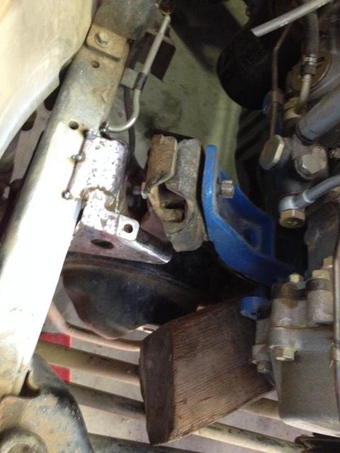

This is the Pass with the wedge.

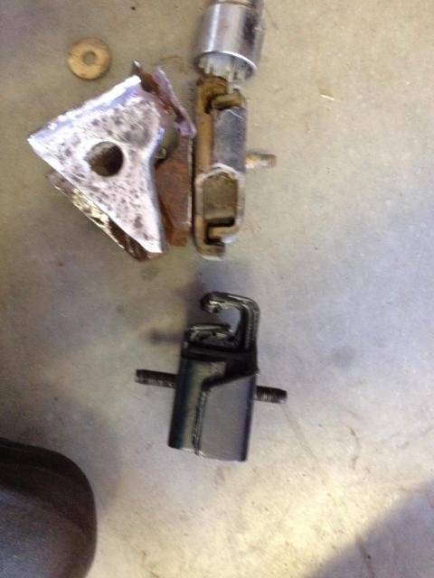

This is the 2f mount because the hj mount won"t fit with out being clocked 45deg.
[/URL][/IMG]

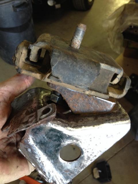

Difference in thinkness
[/URL][/IMG]

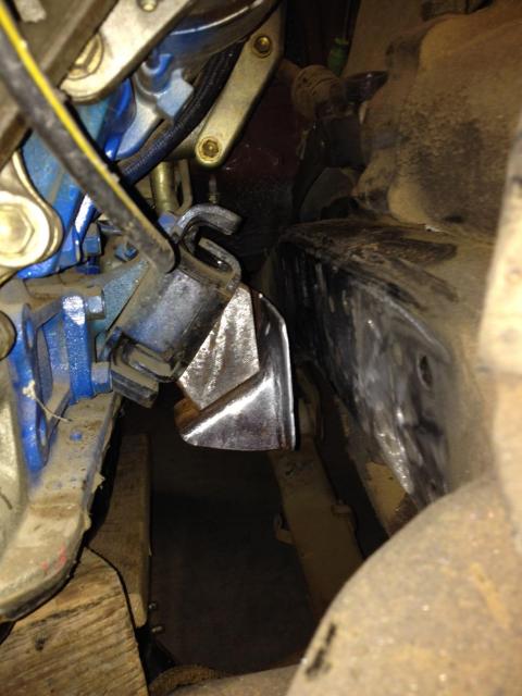

No Matter what I do this is as high as I can get the drivers side. Note: Motor lifted to take good pic.

Pass tacked in
