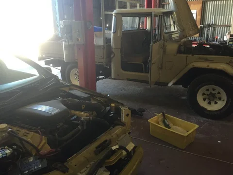

Hi All, would appreciate some advise on installing a 5.4 boss engine and 4speed auto from a ba xr8 into an FJ45. Pretty good with most of the mechanical/fabrication side of things - have hoist, workshop etc...but not well versed on keeping and adapting the 4wd train for the falcon transmission. I have a T5 gearbox from a xr6 turbo if it is an easier conversion but I would prefer to have the FJ as an auto as it will eventually be my daily driver. Any info would be greatly appreciated :)

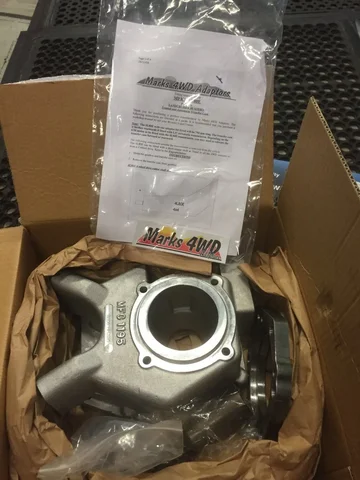

Just for information if anyone else is considering this conversion, the transfer case from any 80 series and 70 series with the 1hdfte can be adapted to suit the transmission on the xr8.
I have opted for the HF1A transfer case out of a DX 80 series without the AWD.....thanks to Wholesale Automatics for the information and bigger cudos if your adaption kit actually works :cheers:

Finally found an option I can run with - having a bell housing adaptor milled up be Dellow conversions for a rebuilt and beefed up 4l80e (basically a turbo 400 with overdrive) this will have a compushift stand alone selectable CPU, full manual, auto and lockup modes. The 4l80e will be adapted to an 80series hf1a part time transfer case that is just about to get a rebuild stresses over on that one! Spent a bit more than I wanted but i think will be much easier to live with.

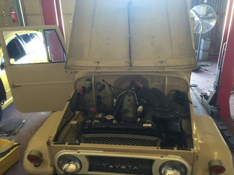

And the fun begins!

What year truck is that? I'm going '64.5 with the R/T and the under windscreen vent.
Very interested to see how you go...
Have you given much thought to cooling? I have been having issues keeping a 308ci V8 cool, not sure how a bigger motor (and possibly supercharger) would go? The biggest problem is the standard radiator is pretty small compared to the radiators in most modern cars. There is only enough room for a single 16" thermofan, so keeping it cool might be tricky. Although costly, you might have to end up with a PWR radiator and SPAL extreme thermofan.
Will watch with interest....
Also, have you given any thought to oil starvation? Not sure about that motor specifically, but i know some engines can have issues with oil pickup/starvation when doing extreme angles. Might need to look into a larger capacity sump (Maybe try ASR) or look at an oil accumulator.
Cheers
1970 FJ45
Only been used as a farm truck its whole life 115000 kms, had a 2f conversion because the old F struggled with a load of hay up the hills :) ......and yep! Under-screen air conditioning
