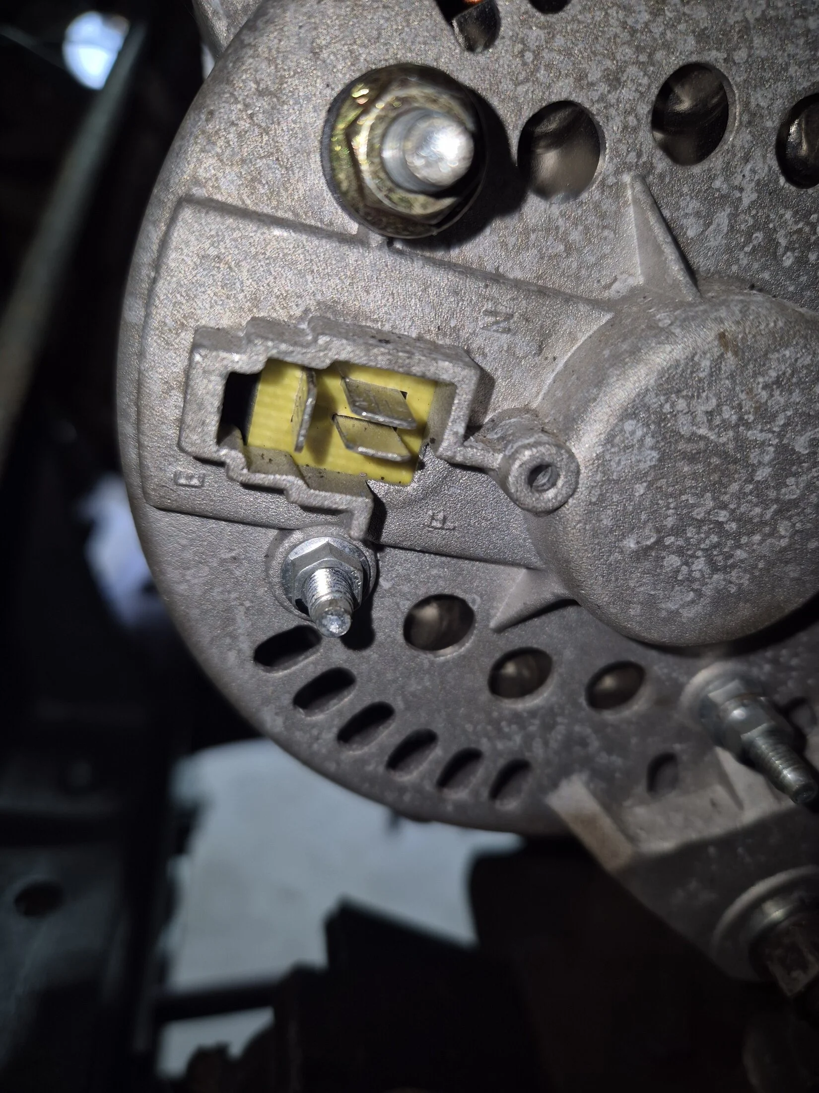

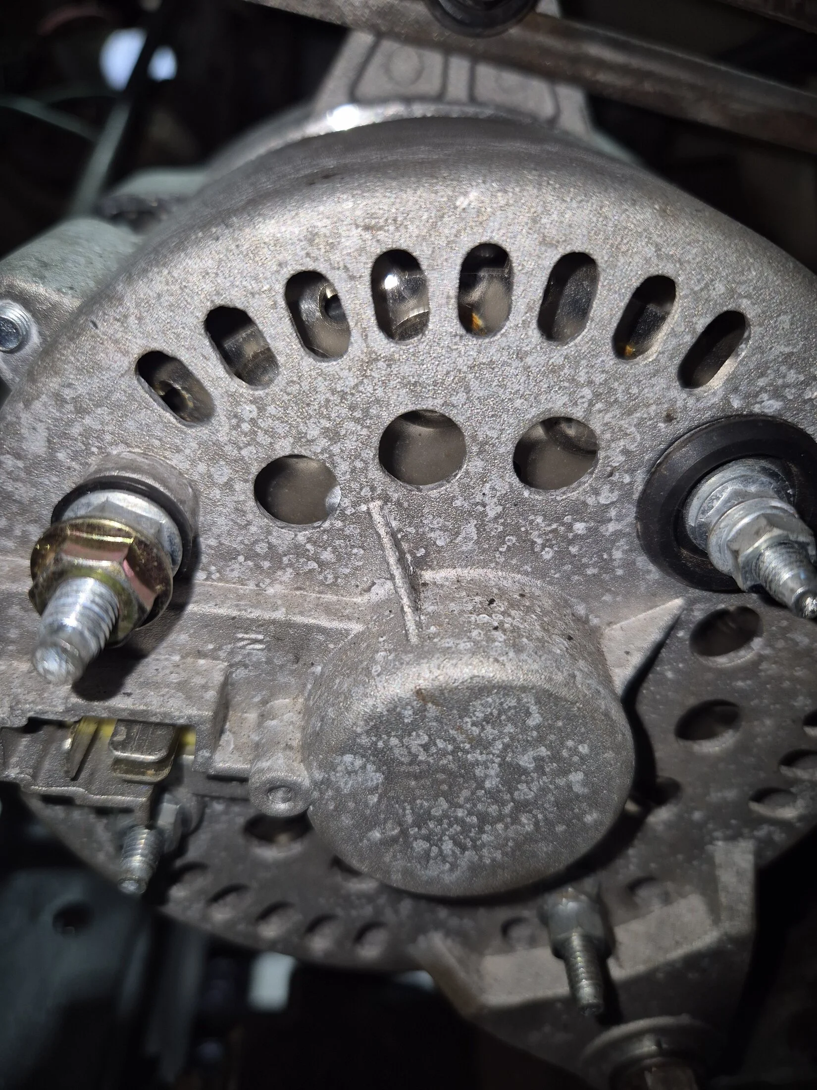

Hello Guys,
This is my first post in here.. appreciate your advise on this..

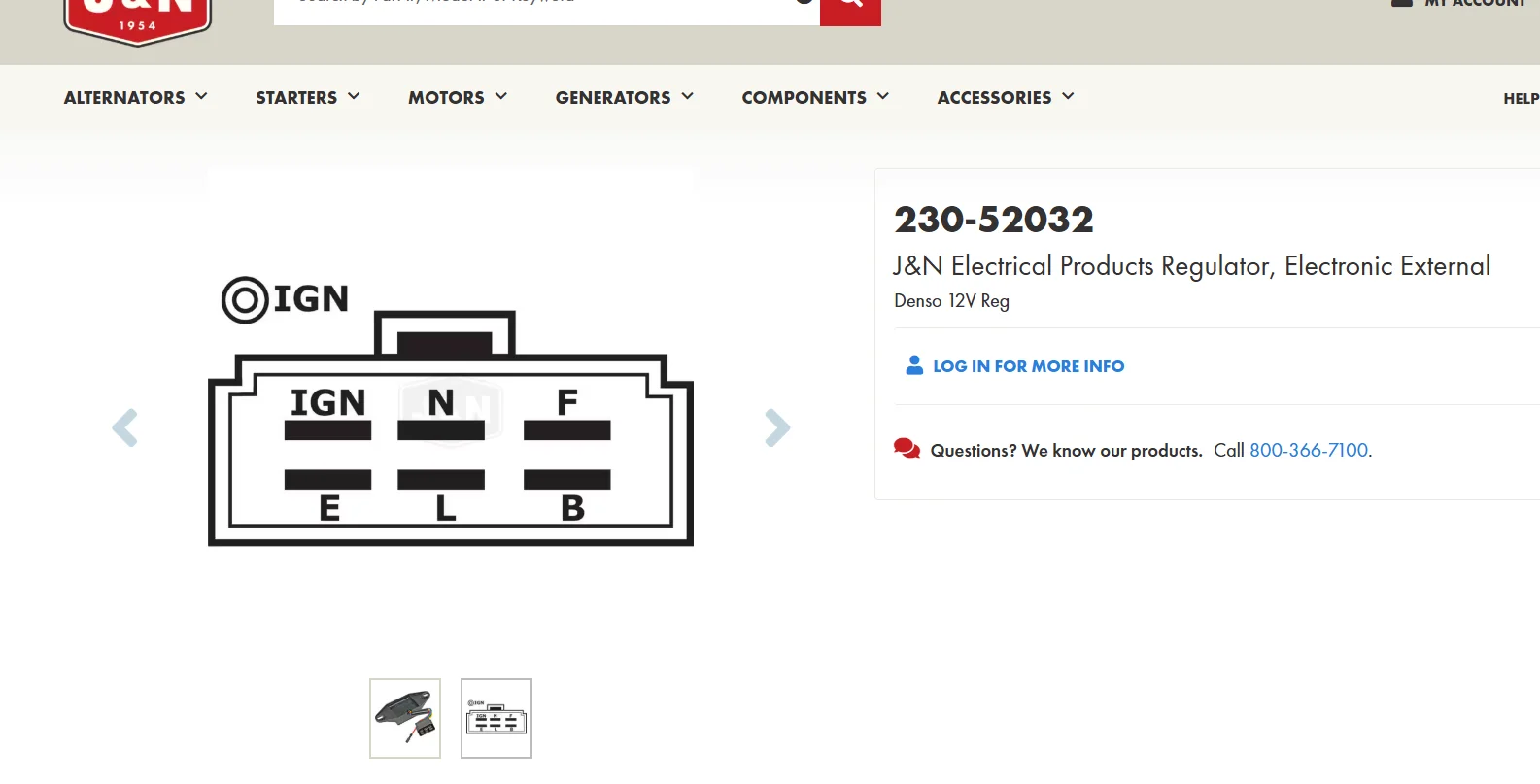

I got Fj45 with 2F and 5 Speed. i dont want to use Fj45 factory VR system andi want to run external voltage reg for my alternator. alternator is from 60 series and was run with J&N external VR
please reafer the attached photos..
if anyone done this please help with the wiring.
Thank you
Interesting. E, F, N seem obvious, B, I, L, and Ign(2) on the VR connector less so - none look heavy enough to handle big amps. Is there an insulated output post on the alternator marked B?

yes mate, insulated output post marked as B. i belive it goes to Battery 50A or bit higher rated wire.
