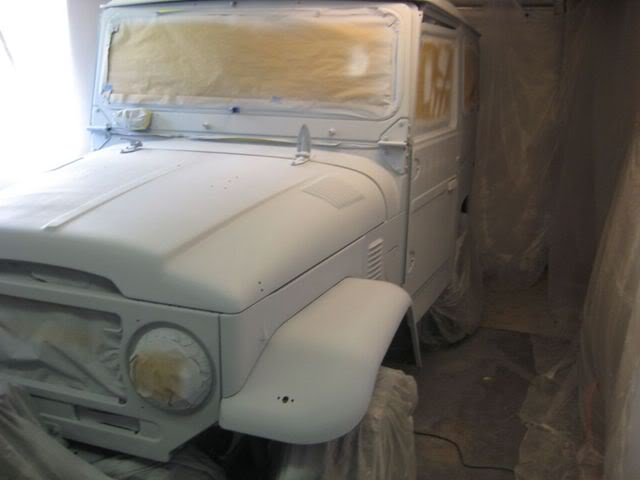

Hi All,
Attempting some bodywork and paint prep for the first time on my 1978 FJ40. Long story short, it was hit and now has two new rear quarter panels and a new piece under the drivers side door. While I am at it I am hoping to get the whole thing painted but I wanted to do the prep to learn and save a few bucks. I am not hoping for full show room quality but I want to to look better than a hack job ;p
First question: There is several layers of paint on the rest of the cruiser, would it be best to just scuff it up and primer/paint over it? or should I look into stripping it down to bare metal? I am hoping I can paint over the old stuff since most of it is in good shape. As for stripping it, does the Aircraft stripper chems work good? I feel sandblasting etc is out of the budget and I am hoping for DIY options.
After I have the body sanded/prepped what are my options for the order of painting it? I have noticed there are different types of primer (sandable, etching, sealing, ect). After talking to a local paint supply, I was hoping to roll on a primer (and sand it), buy the paint myself, and have a local body shop spray it.
Sorry if the questions are common sense, this is my first leap into body work and painting and I am learning as I go.
Now, since we are all picture whores, a picture ;):
IMO. Taking all of the old paint off is always "best". This is do to it can hide small pockets of rust that may not otherwise be noticable. I would say depending on what your intended outcome, budget and use would be should determine your method. If you are looking for a show quality daily driver and money is no object then let a pro do it all. If you plan on wheeling then I would suggest just do it all yourself. You need an etching primer to go back on any bare metal, high build or "sandable" over that, then color. You can get a cheap HVLP spray gun that most portable compressors will run and some single stage color. It really isn't that hard to do. Pick a panel (fenders are good practice pieces) to practice on until you get it down. If you screw it up just sand it back off and try again till you get it down. I have some good friends that do a lot of ato body work that kind of taught me, but I was pleasantly surprised at how well my first paint work turned out. Not professional work but looks decent and nothing that will upset me too much if it gets scratched up. The aircraft stripper is OK but has a hard time with some finishes. You would probably be better off with a paint removal wheel on a grinder or an electric sander (or pneumatic if you have a good compressor). Paiting can be a lot of work but really doesn't take a lot of skill to get a descent looking truck. Oh yeah, solid colors are much easier to spray than anything with a lot of flake if you go the DIY route.
