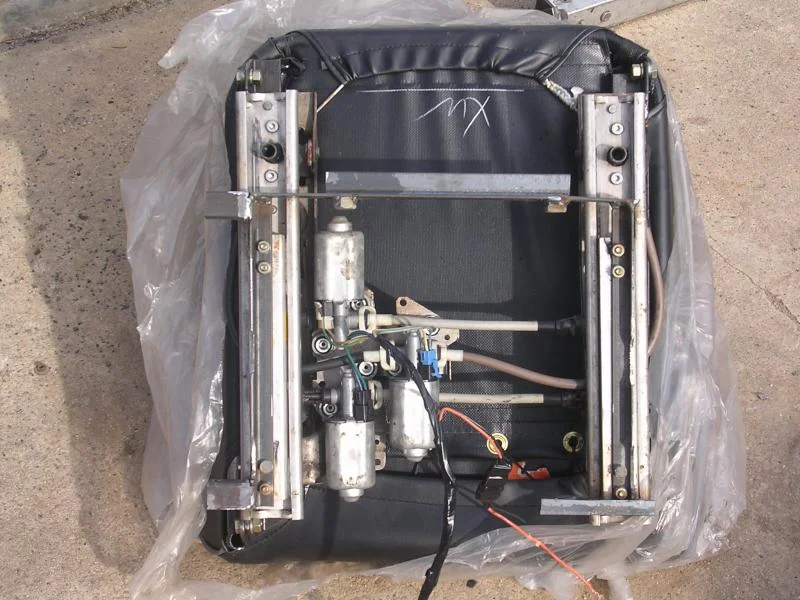

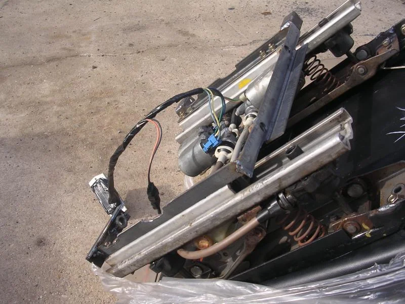

we slow down because of parts. we decided to do something that you would not see on most trucks. we bought a prp seat and dad did not like the fact that he could not move the seat so we went to the junk yard and tried to find a eletric seat motor assembly first we found one out of an astro van we were able to mock it all up and then it was way too tall so we went back to the junk yard and got one out of a 94 carmero and we made all of the brackets it is going to work the only problem is that the cables (that go from one side to the other side of the seat they are the grey and brown things in the picture) were too long so we took the cables off of the astro van set (they were a little shorter) all of this took about a weeks of tiime to find the right parts and make all of the bracket (we can only go so fast when you work for only 2 hours)
