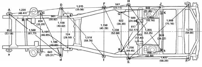

Can someone measure or know the measurements of the outside of the frame where the coil mounts are located. Thanks in advance.
front or rear? front of the frame is much narrower than the rear
neither coil rests on the frame they both rest in pockets on the side of the frame, what specifically do you want to know.
Thanks. I think that picture will work. I was looking for the front. Forgot to mention that. Im going to be putting a FJ 80 front axle in my Tacoma sometime later this year and am going to run coils. I was wondering how the Tacoma and FJ frame widths differ to see if I need to move the coil mounts on the axle.
