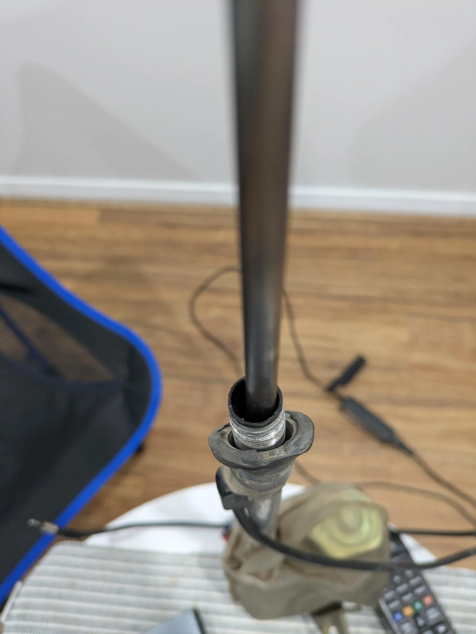

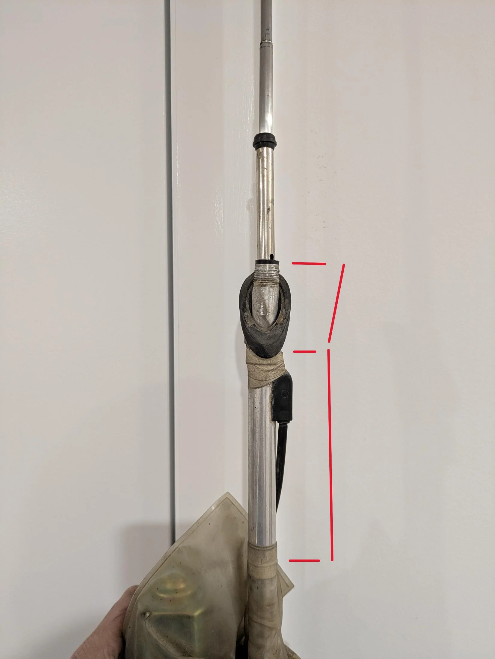

Here I noticed the antenna assembly bore was not straight.
You can see here where the mast is contacting the bore.

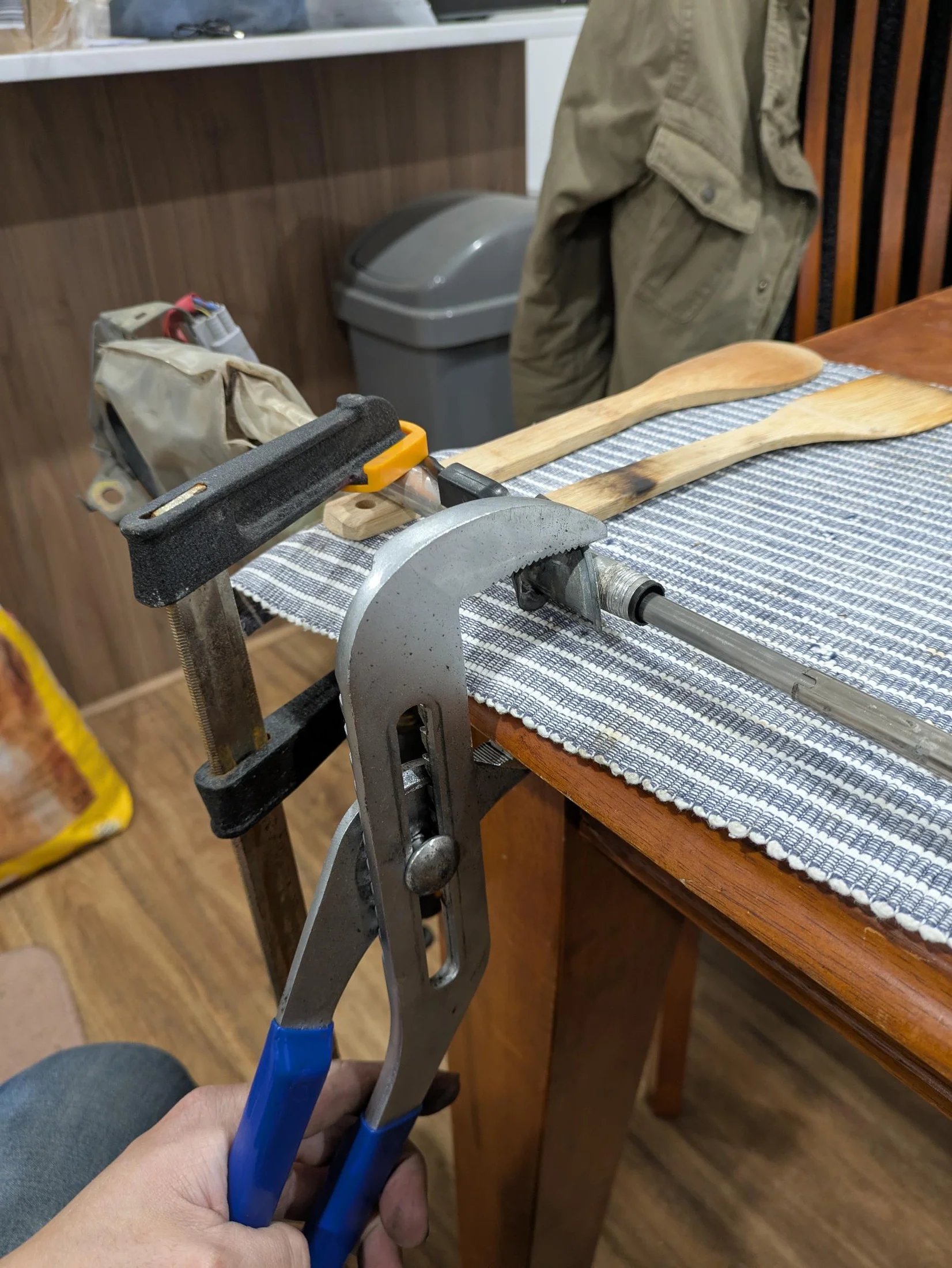

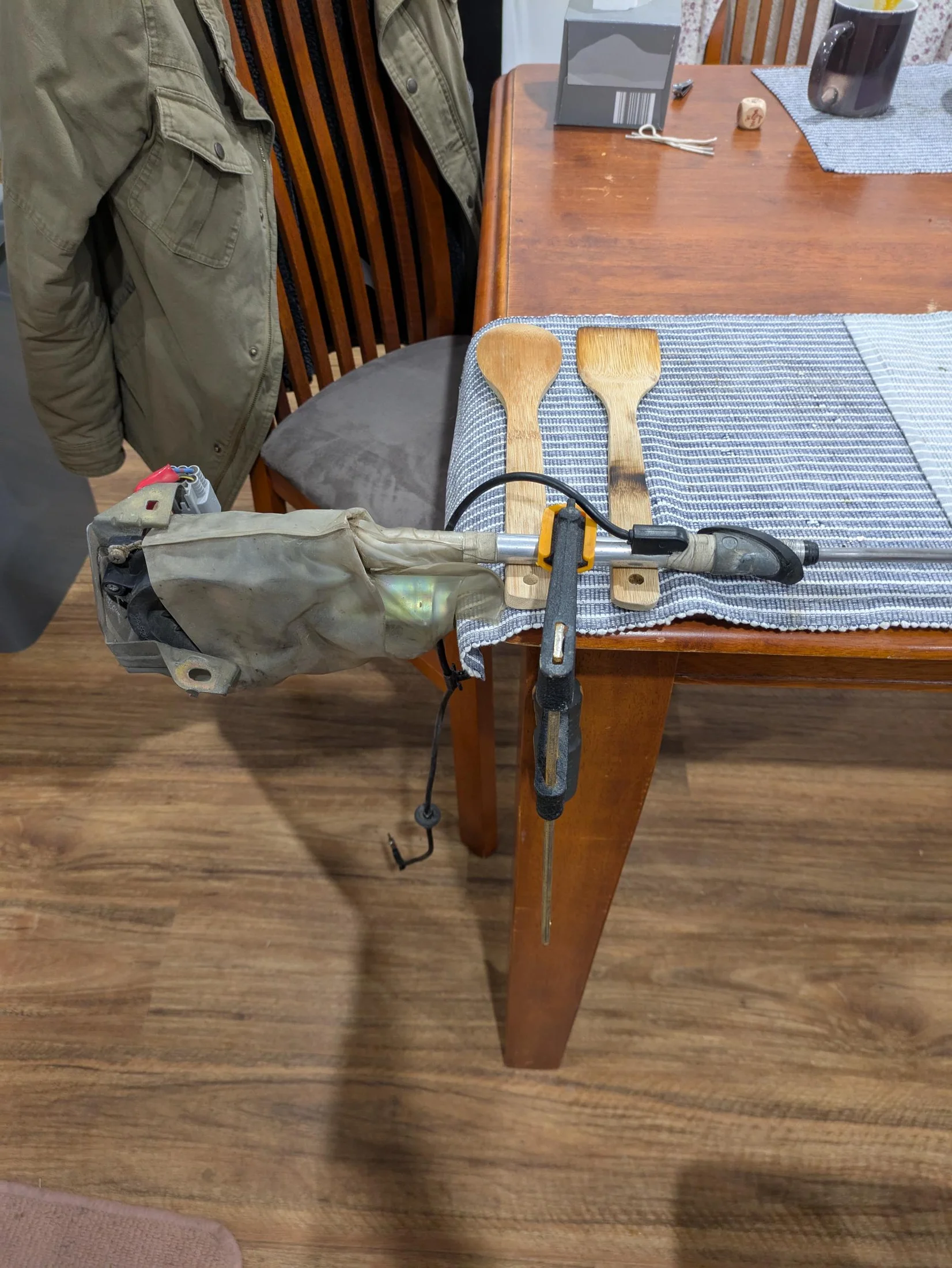

Below is my fancy workbench where I clamped the antenna assembly.

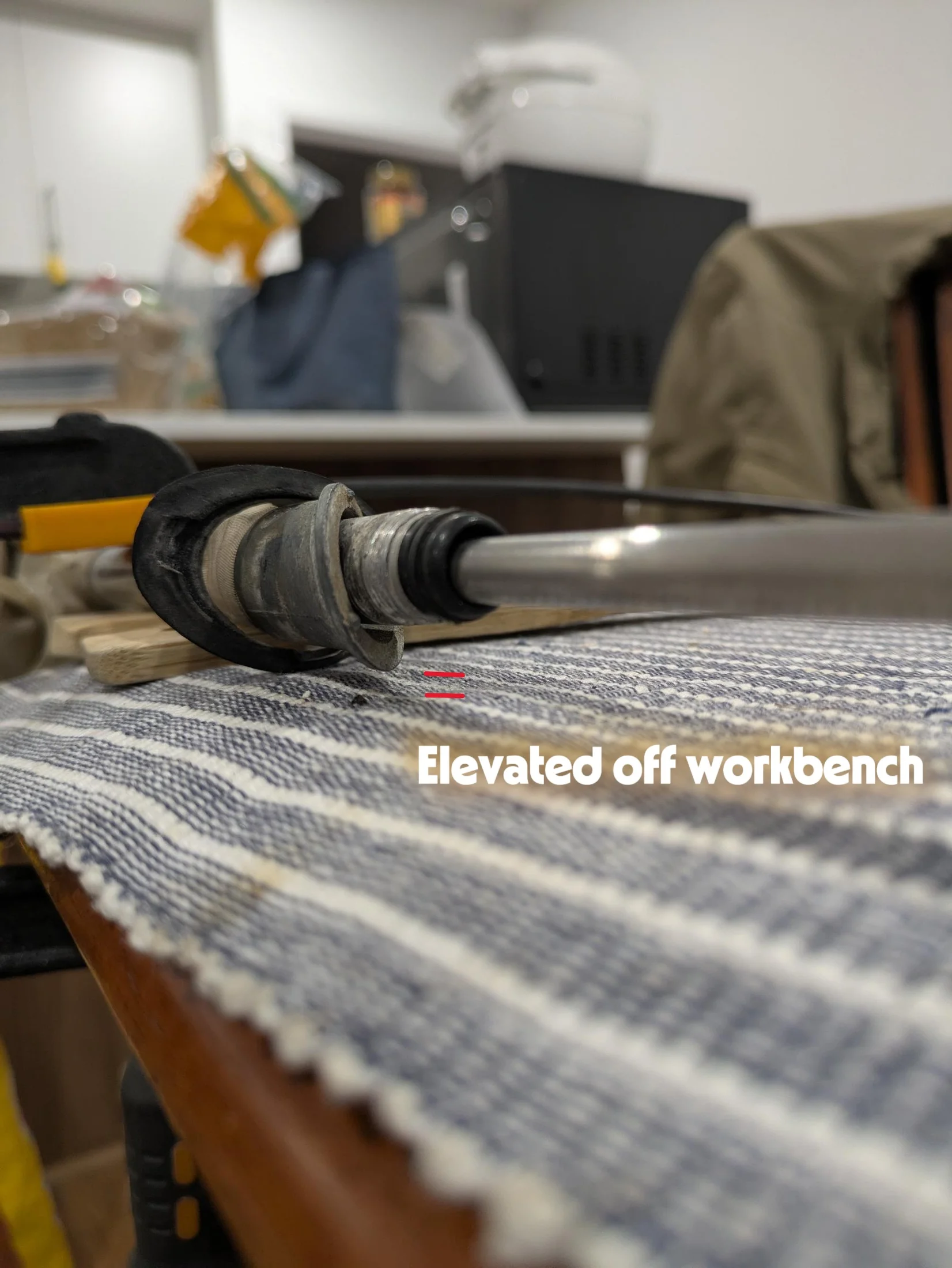

It should be observed that the antenna assembly must be elevated such that the face that meets the fender is elevated off the workbench.
With one end clamped but not too tight as it is aluminium, I used multigrips to bend the face straight again.
Once I had bent the face back straight (didn't take much effort), I checked the telescoping mast and I could now easily slide the largest diameter section in and out of the bore; in my haste to confirm the repair I forgot to take more pictures.
