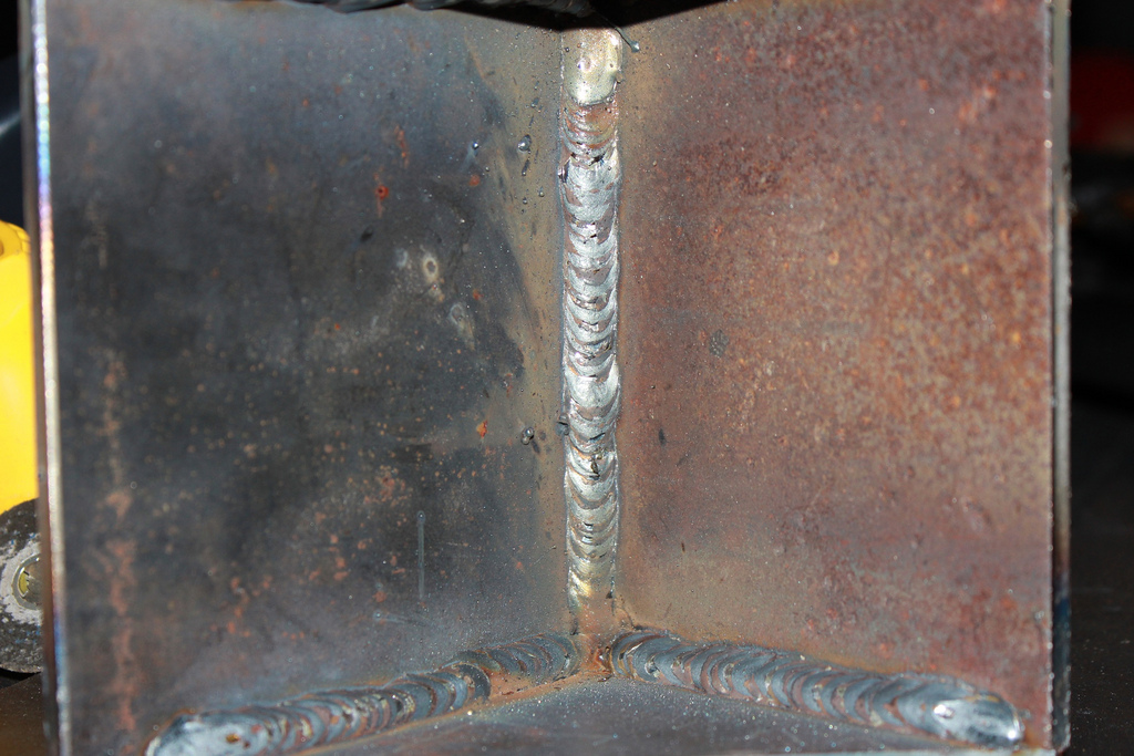

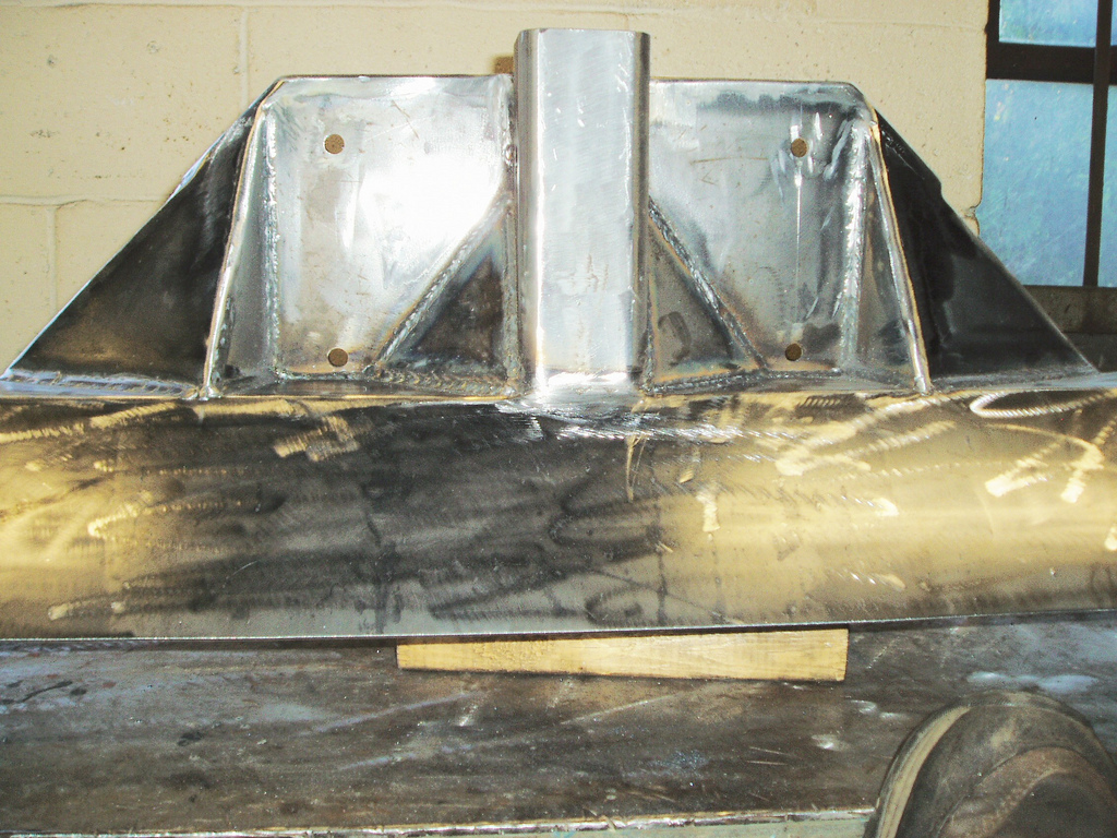

Had a friend come by earlier today who is pro welder. I got a free welding for beginners class :).
Burned my first welds on some transfer case mounts...not that bad. Still got a LOT to learn.
What you guys think?
Looks good Jon. They look a little on the cold side. You should see color distortion along the weld. It stands out well in the center triangles in the photo below. Try turning up the voltage and wire feed speed a bit.
Practice practice practice
off to a good start. crank it up a little more so it will go a little deeper into the metal.
