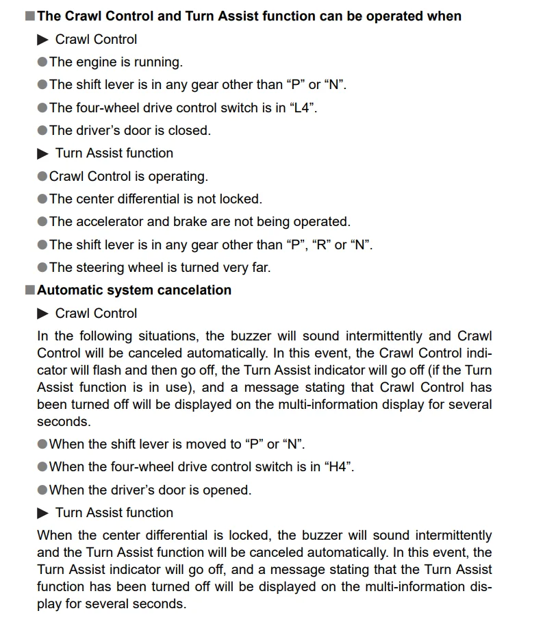

Crawl control only works in 4lo, so if you are not in 4lo that's what's stopping it from working. Also your center diff has to remain unlocked for crawl control to work

As previous poster mentioned, CC won’t activate with diff on in 4lo
VSC is also stuck in off (which is great for sand)
I think you can still use crawl with the CDL on. Eric Sargent's video says that at 0:30 and the 200 he is in is >2016 MY. Mine is a 2013 and I think I can use crawl with CDL locked but I don't really remember as I don't use crawl that much. Crawl is awesome but I don't find I need it much. MTS at "Rock" is almost "Crawl" but you get to use the gas pedal.

To get Crawl to work.
- Must be in 4LO
- CDL can be locked or unlocked
To get turn assist to work
- Must be in 4LO
- CDL must be unlocked
- Crawl Control must be engaged
- Then Turn Assist will work
Sounds like you are doing it right, that's odd. Might be a stuck switch or something else.
