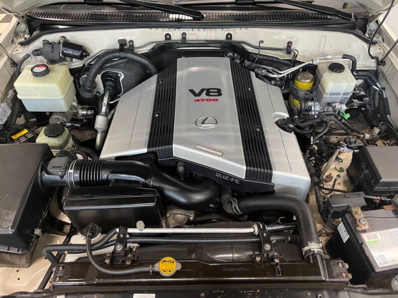

hoping for opinions as to whether or not the undercarriage looks decent with the undercoating or if there are some red flags im not seeing since im a total noob. i'll also attach pictures of the engine bay which looks quite decent from the photos, but if i do decide to go check it out i'll make sure to bring a flashlight and inspect every crevice in addition to PPI.

Looks a little sketchy to me with the fresh undercoating. Others from up north with more experience can weigh in with first hand knowledge. I can see some delaminating of the center transfer case support cross-bar.
In looking at the selling dealer website photos, the seller didn’t care to replace the missing lug nuts on each wheel.
If you live where they salt the roads, maybe.
If you live where they don’t, hard pass.

Yes, but covering over rust with undercoating (what has been done in this case) isn't the way to do it. You want to apply the undercoating when the vehicle is new or otherwise rust free.
