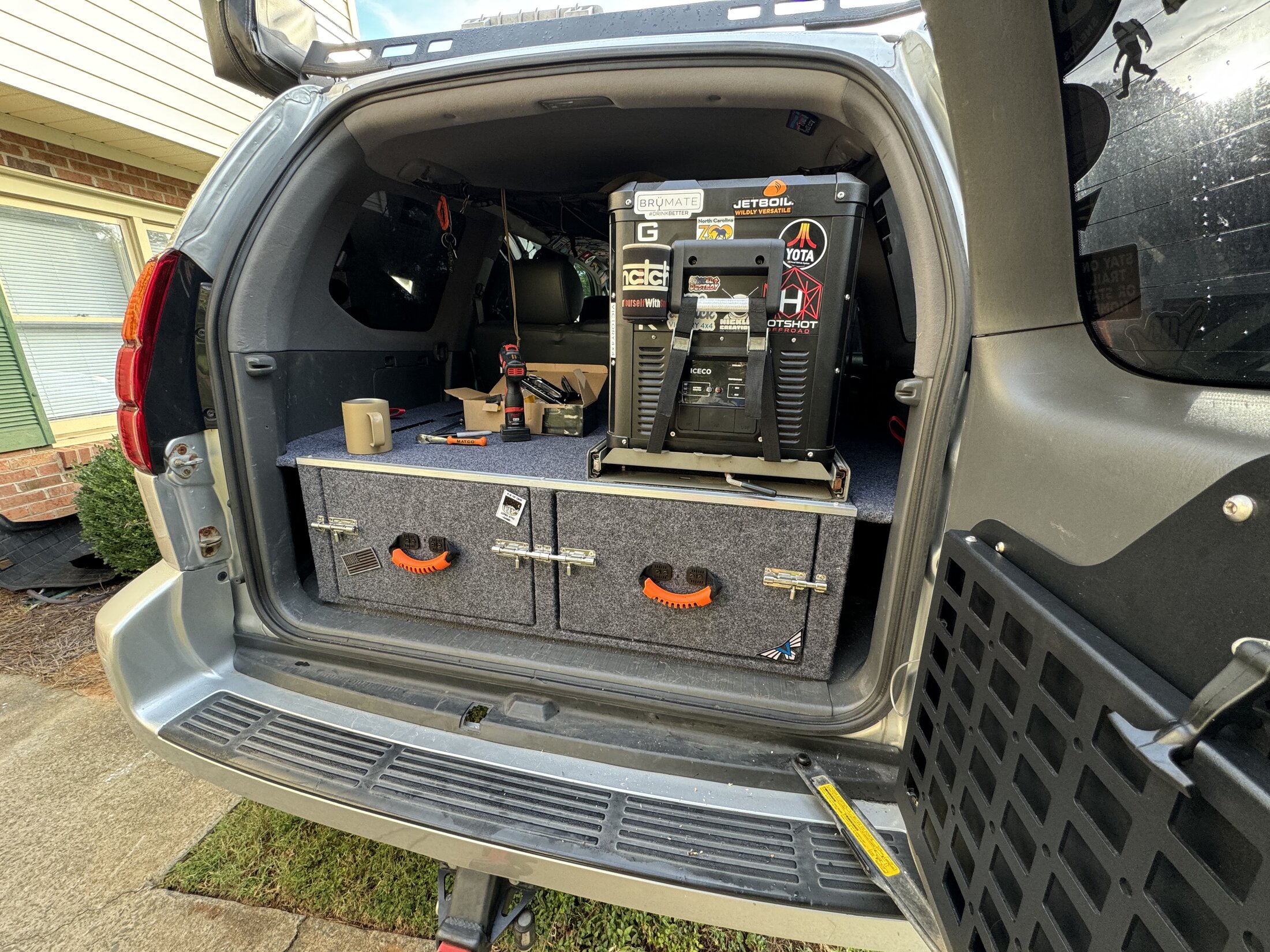

Finished my Drawer Build.
Aug 21, 2021
2
40
Monroe, NC

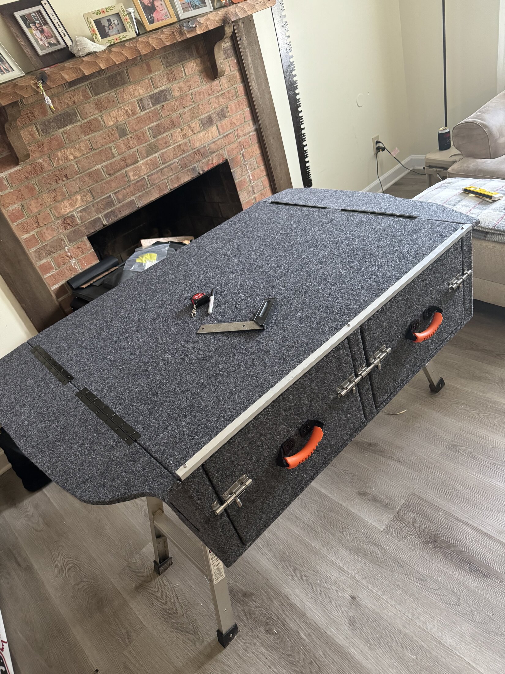

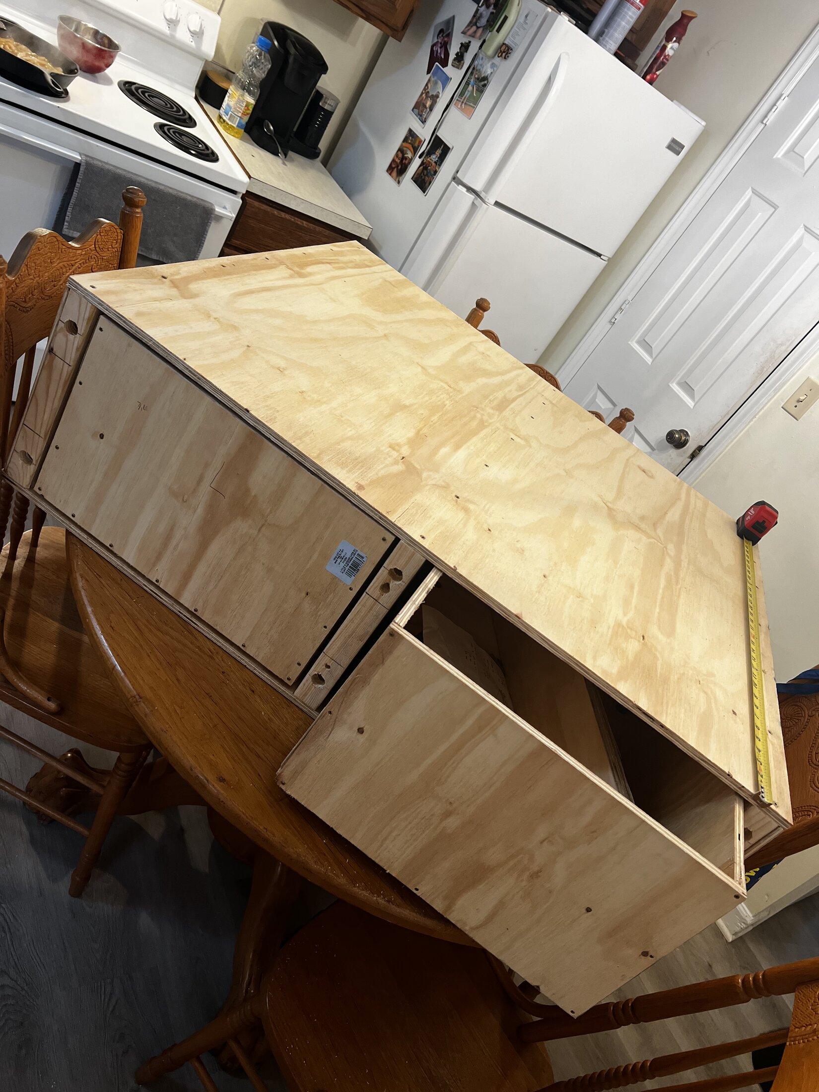

Dimensions are 36” deep x 42” wide x 12” Tall. 15/32 Pine and couple 2x4’s. UHMW slides, handles, piano hinges for the wings and latches all from the jungle store.
