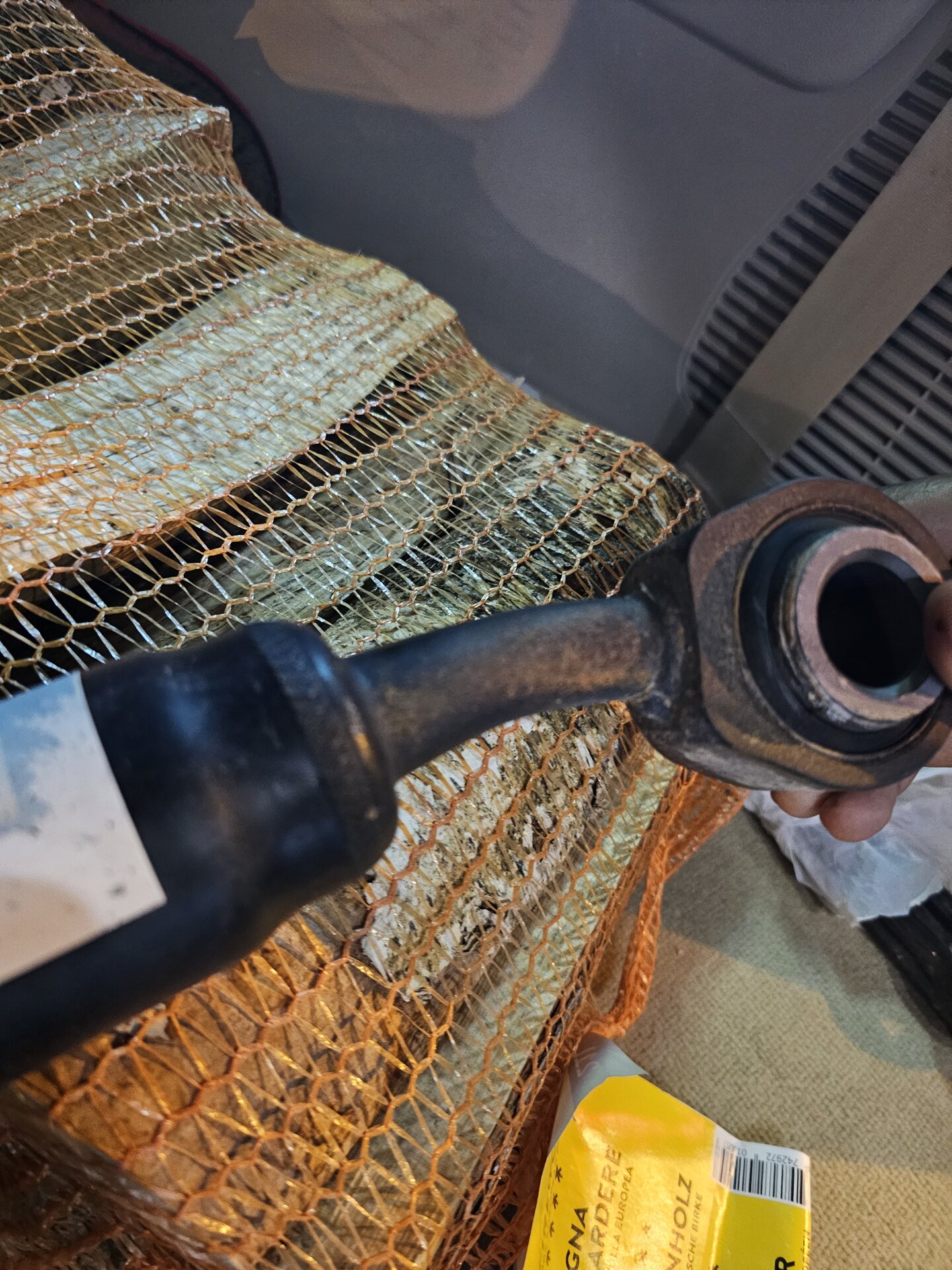

So I was looking at the undercarriage of my lc300
And I notice this
Looks like that was one hell of an impact
Worst part is I don't remember anything happening.
I'll remove the fuel tank skid plate and check the tank.
Edit: looking at old photos from 5 months ago - this dent was present. No idea how I didn't notice it. Ofcourse no issues since then should be fine. I am not in Qatar at the moment but when I'm back I'll inspect it closely.
Literally nothing out of the ordinary.
Driving it the same way I used to drive every other stock cruiser I owned which include lots of offroad driving.
Not one event really stands out.
I did add a spacer lift a few months ago, could have possibly helped with that outcome but yeah...ooph indeed
You bottomed out the shock. Common outcome of spacer lifts. The min length of the compressed shock doesn’t change. Tossing a spacer on top and not limiting up travel with bump stops puts it outside of its operating range.
