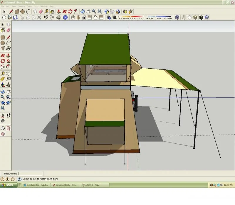

Final design is in...all comments welcome
Based on a Flip Pak operation..roof opens and folds back, Large RTT pops up (5' x 14') Up 4' to the sleeping bunk (queen size) with a 4" mattress.
Plans include awning track with 14' awning...seperate zip on shower/potty room....slide out 12v fridge,,2000 w Honda generator....2-6v batteries.....30 gal. water tank...tankless HWH with a shower box
Pretty lofty..but I think attainable

Thanks guys...I know it's big, and I was trying to figure a way to do it hard side, but I flunked my engineering degree :p
The answer was right in front of me the whole time. The "mombassa" type folding tent should be relativly easy to do. Although the shear size will offer a bit of a challange, I'm sure someone will be able to make it.
I'm making the inside trailer part with a fold down table and 2 fold down benches. That will offer a place inside to eat for two....and once the table and benches fold down, it will offer a 5' x 7' open space for dressing or w/e. I'm torn to do a pull out kitchen on the tarp side. It's still evolving but I like the direction it's going now. I was not on the previous design.

Well you have designed a pretty ambitious project there, but after seeing what you did before I think you are up to the task :beer:
You may want to rethink the open window above the "potty room" :D.
Looks great. With the Mombassa coming in several sizes you should be able to find one that will work.
Lol...good point!!:flipoff2: Not all of us can afford black/grey water tanks!!
I'm hoping that I can find a custom tent maker(but using the Mombassa type look...or I may buy a real heavy sewing machine and attempt it myself. After much thought about a lifting mechanisum, I think I'll have to install the bows to hold the tent out once the flip is open.

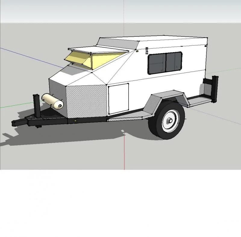

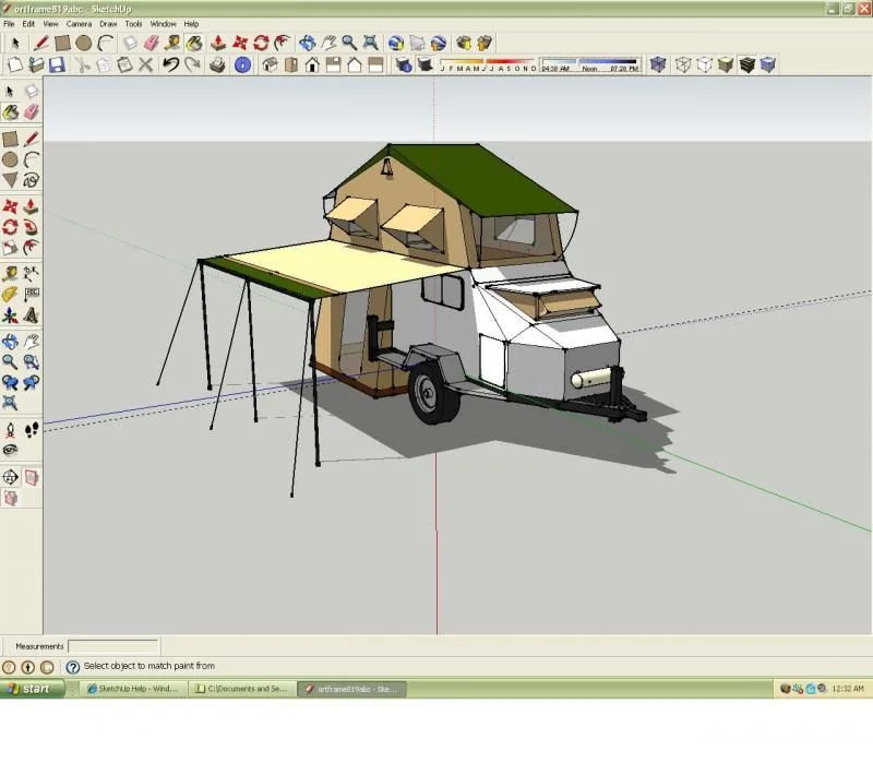

Here's a few (including a cutaway) with the trailer closed and open exposing the inside. Although the plan is not to use the interior for sleeping..I may design the table to fold down.
