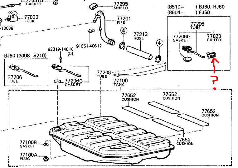

Does anybody know if there is a pre-filter which the gas goes through before it makes it through the suction tube (tank exit)? I am using an old FJ60 gas tank on my diesel and I am having some fuel restriction issues. An acquaintance said they thought there was a small filter right at the suction tube (within the tank). Since gas is a lot less viscus than diesel it may create a problem.
Just wanting a second opinion before I pull the tank.

looks like maybe... maybe not..
Looks like it to me. Weird that I did not see than in my body manual.
Time to pull it.

looks like there is a filter is on diesel and gas... I'm not sure if they are identical filters, it looks like they have a different part number.
When I removed my 85 FJ60's tank it didn't have one on the pickup tube in the tank. I think it may have gotten lost when the tank recall was done through previous ownership. I have the tank out now and steamed it, shook the hell out of the tank and it's not inside it. I got a new pickup and the feed line does have a filter almost like a plastic strainer basket clipped to it.
Do you think that this filter is fine enough to restrict cold diesel fuel? Or only fine enough to filter large particulate?
To be honest, I have looked at several fuel diagrams like that and this is the first one that I have seen to have a filter that obvious. I may be looking at older tanks diagrams.
