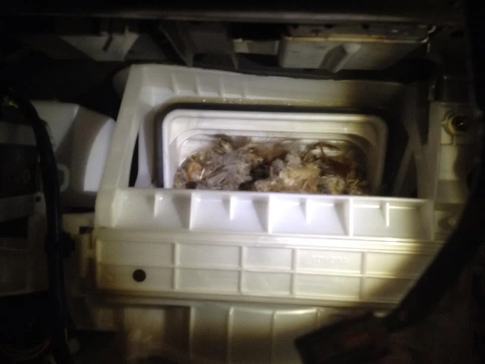

Festus, however, stank. A dead mouse was found in the engine bay, but a trip to the car wash and lots of spraying did not remove the stank. Back in Utah I began to really dig into Festus. A full handwash from top to bottom, inside and out to familiarize myself with any dings or dents. None. Again with the hose in the engine bay- to no avail.

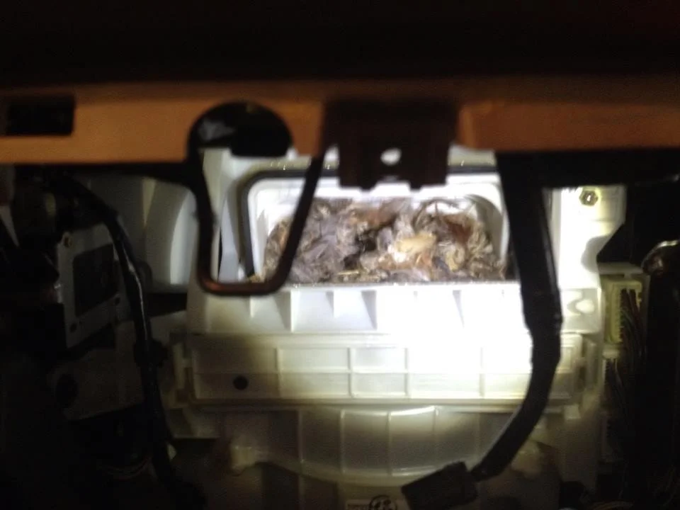

Stink, stank, stunk. everytime the A/C kicked on- Ah-ha! maybe a new cabin filter? Where is that darn filter anyway- not in the engine compartment... oh, behind the glove box. Pull the glove box out and I saw what appeared to be a chicken nesting back there. Some photos for your amusement.
Um, honey.... grab the shop vac!

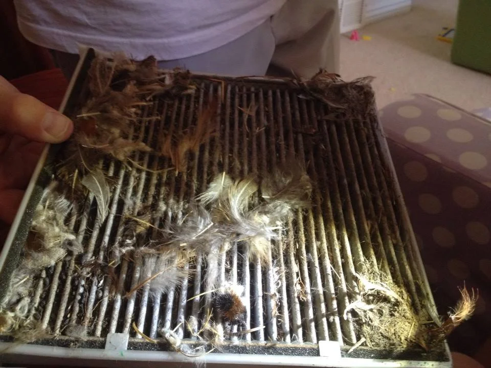

Oh, and the filter itself.
Yeah, time for a new filter.
The new activated charcoal filter has really helped out alot, but I still get a small puff of au' de mouse when the HVAC kicks on. Where is the outside air intake located so I may spray some febreeze in there or something.... ?

Good read, try spraying some bleach into the exterior inlet vents and it should help with the smell
Can you tell me where those vents are? The cowl? Engine bay?
Did you find any mice nests or eaten wires in the dashboard? Found tons of mouse poop and mice had pulled sound deadener to make a nest behind the radio of 4th gen 4R we had. I understood it was stored in a barn too
No chewed wires, yet.
If the smell continues, since recirc pulls air from behind the dash I would disassemble as much as possible and clean.
I would also check behind the radio and under the center console. In those two areas, I found nests that stunk pretty bad especially when the weather warmed up.
I believe the air inlet for the cabin is under the cowl just behind the engine bay.
